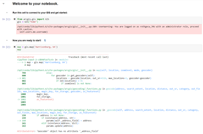

I'm not sure if this is related, but one of my faculty members brought a similar issue to my attention yesterday. He is unable to get a map to display within a Jupyter Notebook, neither from a local installation nor within ArcGIS Online. I tested this from Online, and am having trouble myself, though I am seeing errors generated even with the most basic usage:
I've tried multiple browsers, two different logins, and even the sample Notebooks Esri has published throw an error. I'm wondering if the update to AGOL this past week changed something...

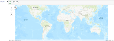

Just in testing this, I tried the statement:
map = gis.map()
map
And this worked, if less than useful at only showing an interactive map of the planet:
It appears to be an issue with the built-in geocoder, as suggested by the error message:
AttributeError                            Traceback (most recent call last)
<ipython-input-8-3ea8a60e307b> in <module>
----> 1 m1 = gis.map('San Diego')
      2 m1
/opt/conda/lib/python3.7/site-packages/arcgis/gis/__init__.py in map(self, location, zoomlevel, mode, geocoder)
    955                 else:
    956                     for geocoder in get_geocoders(self):
--> 957                         locations = geocode(location, out_sr=4326, max_locations=1, geocoder=geocoder)
    958                         if len(locations) > 0:
    959                             if zoomlevel is not None:
/opt/conda/lib/python3.7/site-packages/arcgis/geocoding/_functions.py in geocode(address, search_extent, location, distance, out_sr, category, out_fields, max_locations, magic_key, for_storage, geocoder, as_featureset, match_out_of_range, location_type, lang_code, source_country)
   1118         location_type=location_type,
   1119         lang_code=lang_code,
-> 1120         source_country=source_country)   1121
   1122
/opt/conda/lib/python3.7/site-packages/arcgis/geocoding/_functions.py in _geocode(self, address, search_extent, location, distance, out_sr, category, out_fields, max_locations, magic_key, for_storage, as_featureset, match_out_of_range, location_type, lang_code, source_country)
    196         if address is not None:
    197             if isinstance(address, str):
--> 198                 params[self._address_field] = address
    199             elif isinstance(address, dict):
    200                 params.update(address)
AttributeError: 'Geocoder' object has no attribute '_address_field'
I'm just wondering if something changed in AGOL under the hood that their API does not have working. Is anyone else able to get a map to work in an AGOL-hosted Jupyter Notebook using a location or address?
