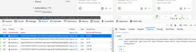

Try watching your network traffic when you click the "Authoritative" filter in the content page and see what it's doing.

That's interesting. I'm getting a Cross-Origin Request Blocked when clicking the 'Authoritative' filter.
16:11:50.370 Cross-Origin Request Blocked: The Same Origin Policy disallows reading the remote resource at https://mobileanalytics.us-east-1.amazonaws.com/2014-06-05/events. (Reason: CORS request did not succeed).
