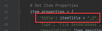

Hi @Clubdebambos,
You could use the Copy Hosted Feature Services tool in the following toolset.  You would just have to update the 'title' in the item_properties variable on line 67 so it does error trying to create a service with the same name.  Ex:

Hi @JakeSkinner
Thanks for the reply. It seems like it is a little overkill to have to download and re-publish just to make a copy a feature service. I am also looking for a solution that doesn't use ArcPy (although I can see that is mainly for the custom tool and setting the workspace in ArcGIS Pro and can be taken out to just use the API) and is purely the ArcGIS API for Python / Python. I was hoping that I have simply missed a simple method call amongst the copy methods 😅
Fantastic toolset all the same, thanks for sharing, I definitely have use for that for other workflows.
