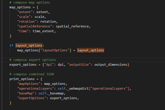

Issue:
When you specify layout options using webMap.Print these options are ignored. This includes title, author, copywrite, scalebar and legend.
Code:
wm_item = gis.content.get('item')
wm = WebMap(wm_item)
ext = {'spatialReference': {'latestWkid': 3857, 'wkid': 102100},
               "xmin": 14219202.665619811,
               "ymin": -3017623.8659692756,
               "xmax": 14225164.753826046,
               "ymax": -3005929.0006416594}
 layoutOptions = {
            "titleText": "LADR",
            "authorText": "Oz Minerals",
            "copyrightText": "Copyright Oz Minerals",
            "customTextElements": [{
                "date":  datetime.now().strftime("%m/%d/%Y")
            "scaleBarOptions": {},
            "legendOptions": {
                "operationalLayers": ids
printed_file_url = wm.print(file_format='JPG', layout_template="A4 Landscape",
                                 extent=ext, layout_options=layoutOptions)
 The problem in the esri code is this, it hangs the layout options off the map_otions whereas they should be on the print options

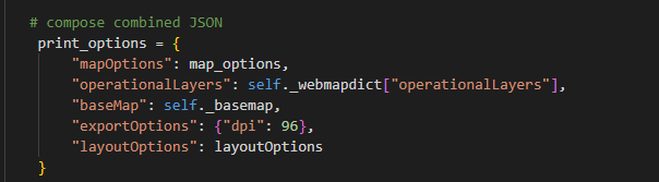

I think this is how it should be:

DavidWilton
Here is a work around if anyone else runs into this
        e = polygon.extent
        # legend
        ids = []
        for layer in wm.layers:
            ids.append({"id": layer.id})
        layoutOptions = {
            "titleText": "my title",
            "authorText": "my author",
            "copyrightText": "Copyright",
            "legendOptions": {
        # DW another esri bug? Doesn't add the token on print or
            layer.token = gis._con.token
        map_options = {
            "extent": ext
         # compose combined JSON
        print_options = {
            "mapOptions": map_options,
            "operationalLayers": wm._webmapdict["operationalLayers"],
            "baseMap": wm._basemap,
            "exportOptions": {"dpi": 96},
            "layoutOptions": layoutOptions
        # dw don't use wm.print the print from the web map as it has a bug which causes the
        # legend not to display.
        res2 = export_map(print_options, format="JPG", layout_template="A4 Landscape", gis=gis)
        print(res2.url)
