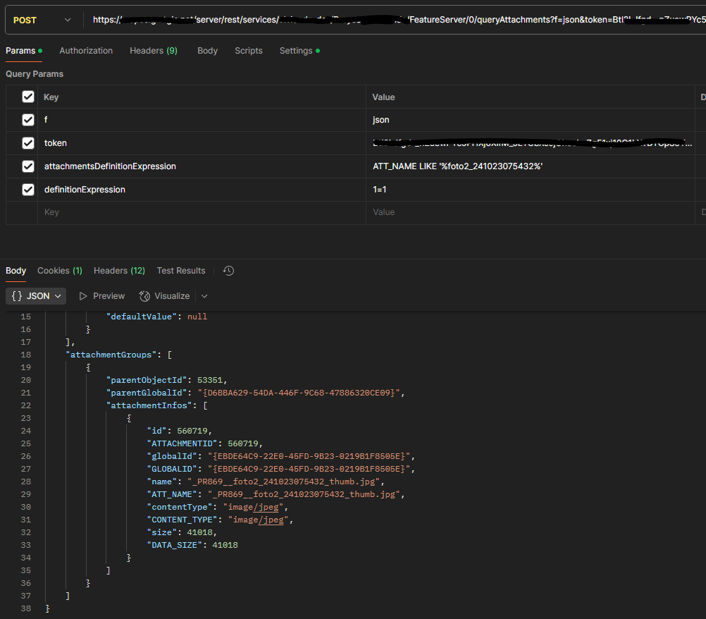

I performed the same query using the REST API, and it correctly returns the single attachment that matches my criteria.
My organization is using ArcGIS Enterprise 11.3, and I myself am using the gis api for python 2.4.0 (the one that comes preinstalled with arcgis pro. Currently using ArcGIS Pro 3.4.0)
Raul
For anyone having a similar issue, I created this function that uses the REST API to perform the query. I'm still using my instance of FeatureLayer and GIS objects :^]
