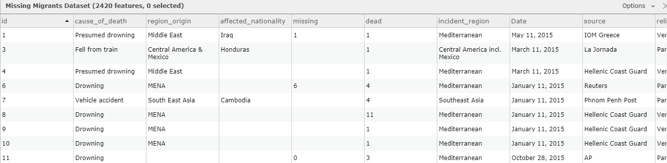

A snippet of the feature layer table from Portal for ArcGIS
