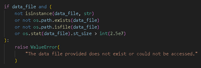

Today, I have encountered the same issue when running the "FeatureLayerCollectionManager.overwrite()" method with a 90 MB zipped file geodatabase. I was using Pro's Python (ArcGIS Pro 3.3.1, and arcgis.__version__ = 2.3.0).
When I ran the same script in a virtual environment where I had installed the 'arcgis' module v2.4.0, it ran without issues. From the image below, it seems that they wanted to prevent large files to be used, but not a single reference to this in the documentation.
If you are using Pro, I would suggest cloning the default virtual environment and updating the 'arcgis' module there.
An alternative would be to install the latest version of the 'arcgis' module in a standalone, virtual environment (completely decoupled from the Pro installation).
