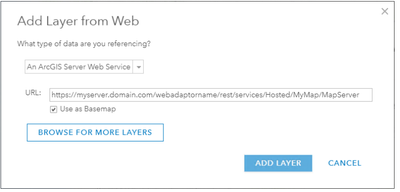

Hi, trying to add a service as basemap to a web map with python (manually i can do this analogue screenshot  below).
Unfortunately i don't find any example how to do this.
thanks for any help.
