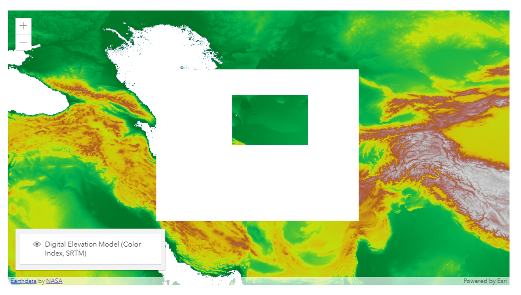

In JS API 4.17, WMTS layer is not being rendered correctly when the user zooms out, and it creates blank areas randomly. I can also see that this issue also exists even on your example map. WMTSLayer | ArcGIS API for JavaScript 4.17
I have confirmed that several users that they have the same problem.
JS Team, could you please provide a workaround/solution? It is blocking us. This issue does not exist in 4.16, but we have to use 4.17 because it has fixes for other problems that exist in 4.16.
I appreciate any help you can provide.

Thank you for reporting this. We are aware of this bug and have already fixed it for the upcoming release. You can test out this fix using https://js.arcgis.com/next in your app. Here's a codepen using /next with our WMTSLayer sample: https://codepen.io/annefitz/pen/GRqBpJr
Let me know if you are still seeing issues after testing with /next!

We tested the next version with our WMTS services, I can confirm that is working now but we need to have this fix with 4.17 or 4.17.1 whatever you call for patches. This is a very fundamental feature that we cannot tolerate bugs. It is also a shame that ESRI is showcasing a bug in the example gallery.
