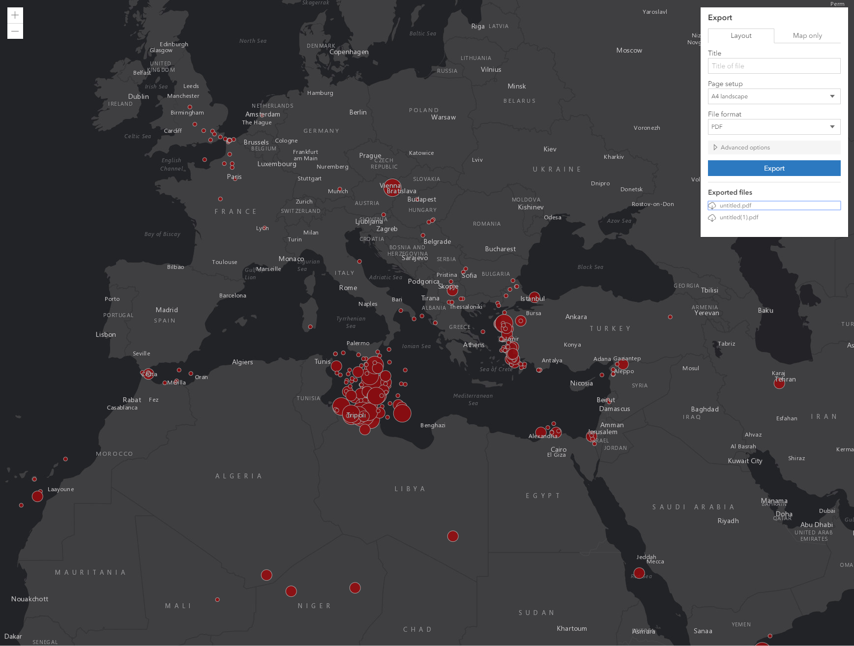

I'm trying to add print functionality to a 4.x solution I'm working on using the PrintViewModel. I'm able to use all the functionality as described in the documentation, but there seems to be an inherent problem where the actual printout (pdf) returned from the printservice only contain a portion of the map that is visible in the browser.

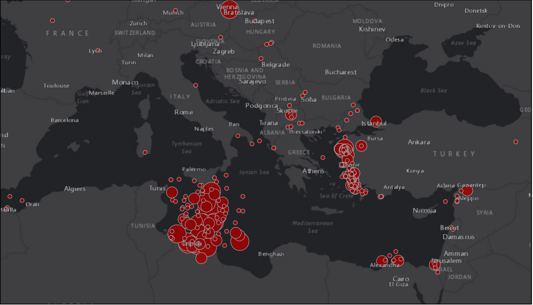

It's very easy to reproduce this by opening the official print sample in fullscreen (Print widget - 4.14), and hitting print. The resulting printout will vary depending on your screen size, but in the majority of cases the printout will only contain a center envelope of the map which is displayed in the application.
Here are some screenshots to illustrate the problem:
This is what the user sees in the browser window when hitting print:
This is the result from  the print service:

Thanks for the input Noah. I actually managed to solve my problem, and create a preview box for the print (using only the printViewModel and some custom logic). My printouts now only contain the portion of the map that is visible within the preview box. The user selects which map scale to use in a dropdown, and the bounding box updates accordingly.
The key to solving my problem was to understand the relationship between pixels and resolutions. Each zoom level has a specific resolution, and that resolution defines how many map units (for example meters) there will be in one pixel. Using this information it is possible to calculate the area that will be included in a printout and highlight this area in the map. You also need to know exactly how big the map image in the printout will be (in pixels).
