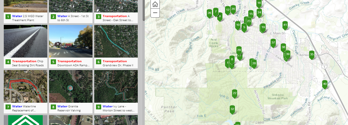

I am looking for a way to view photos both on a map and in a gallery. The idea is to have photos on the side that can be filtered.  Also points on the map that also show the same photo as the symbol.
Sort of like the image below but having photos instead of points.
Thank you

   I am not sure if displaying the image on the map is a good idea. Will the ListView widget not work for your needs?

   Trying to display the photos a on the map would obscure the map to much. Can the user not just click on the point to bring up the photo in the maps popup.
