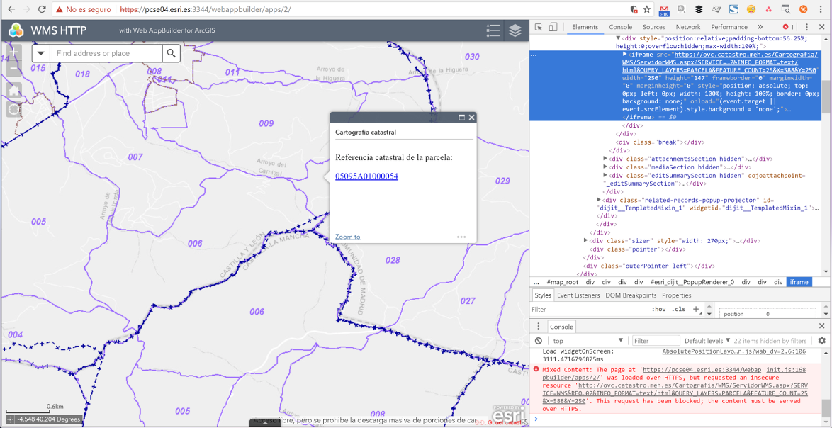

I have a problem trying to load a third party WMS (this one) over HTTP inside a Web AppBuilder app using HTTPs with popups enabled (via this Web map).

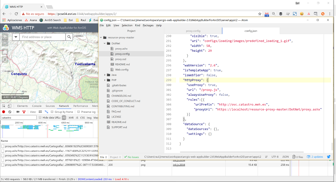

I have added a proxy (using the resource proxy) to the config.json and it seems to work (at first) as you will see here:

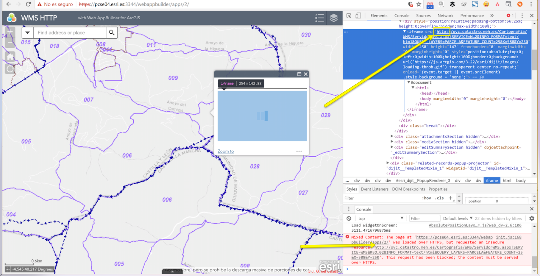

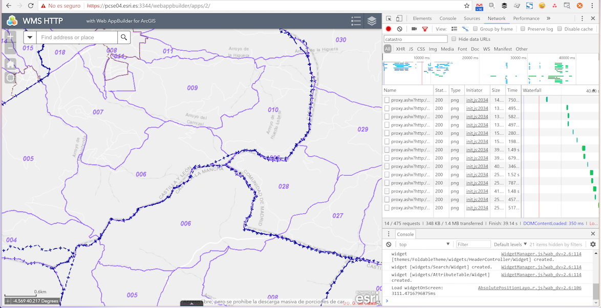

Every call to "ovc.catastro.meh.es" es been redirected though the proxy but then when the popup is triggered:
And if I edit the HTML directly it works:
Anyone know how to fix this? I'm not sure if this is an issue related to Web AppBuilder or to the ArcGIS API for JavaScript // cc: Jianxia Song, Lemao Wu, Robert Scheitlin, GISP, odoe
