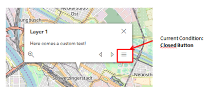

I'm trying to set the "Layer List" button on the popup widget open as the default setting.The goal is when the user clicks on the map it should immediately display the identifiable layers.
Is there any possibility to get such setting?
