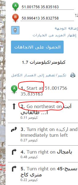

How can I you change the text of  direction instructions (turn by turn)  in Directions widget in ArcGIS Api for JavaScript. For example I want to change the "Start at" to "begging from" or some text in other language like Arabic "تبدأ في"  or some other language that not exist in the default list of Localization language like "Pashto"  or "Persian" (شروع کن).
When I change the localization to Arabic The widget parameter change but the direction instructions do not change.
