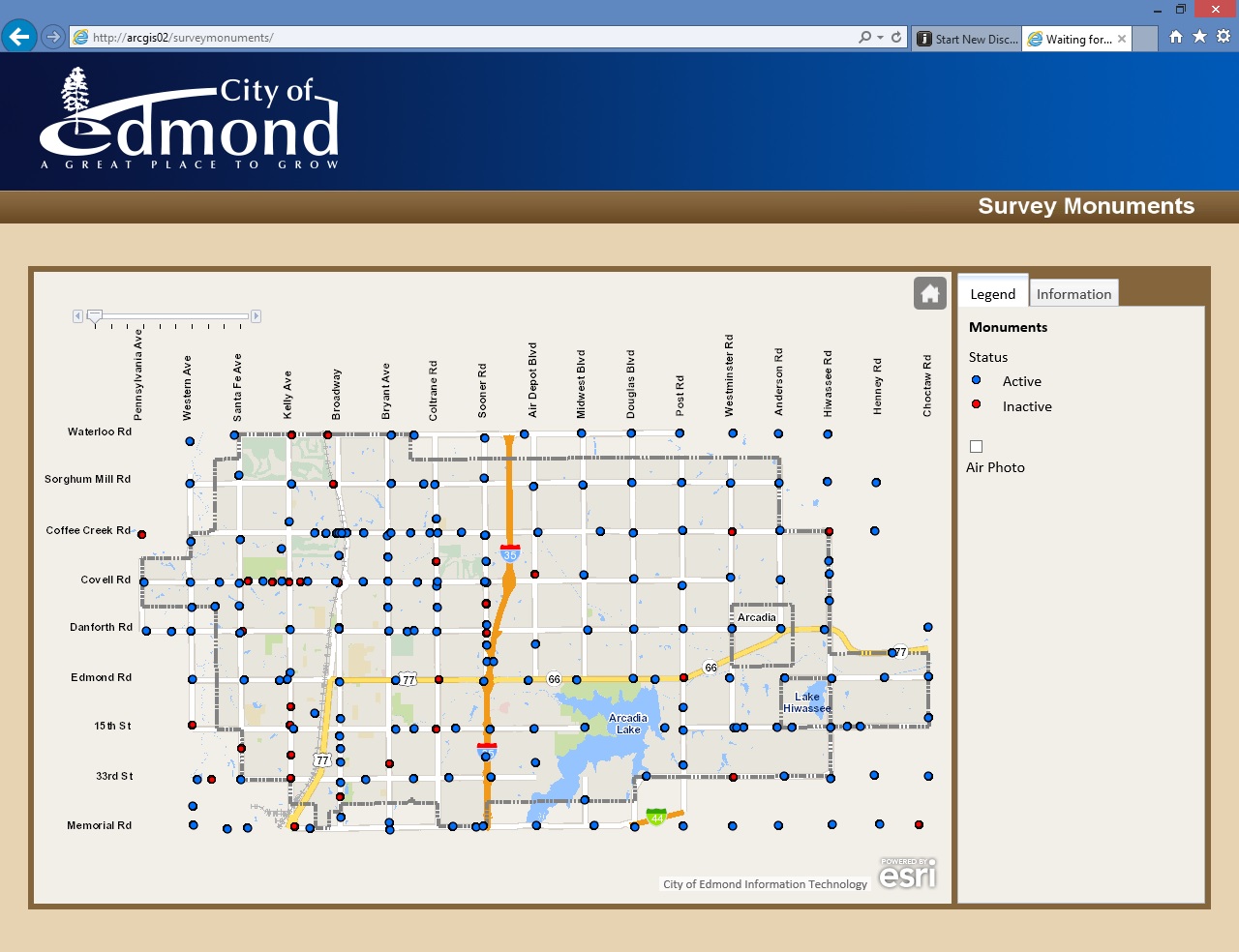

I have an application that works well, yet I am trying to get the map to appear at full scale when the browser is opened in a minimized window.  When the browser is opened at a maximized browser window, the map does appear at full extent.

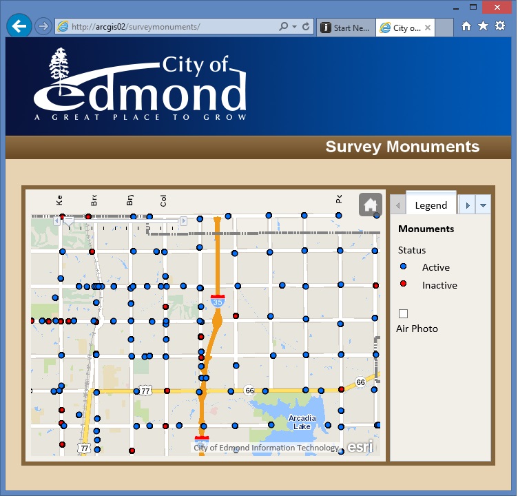

is there a way I can scale the map at full extent when the browser is minimized?  I understand that this may be a css issue.  Below are samples I am referring to?
Browser - Full Extent
Browser - Minimized Window
Notice the difference?
There are going to be users that open their browser in a minimized state, but I want them to be able to see the entire extent of the City.  Also, there is a cached base map used.

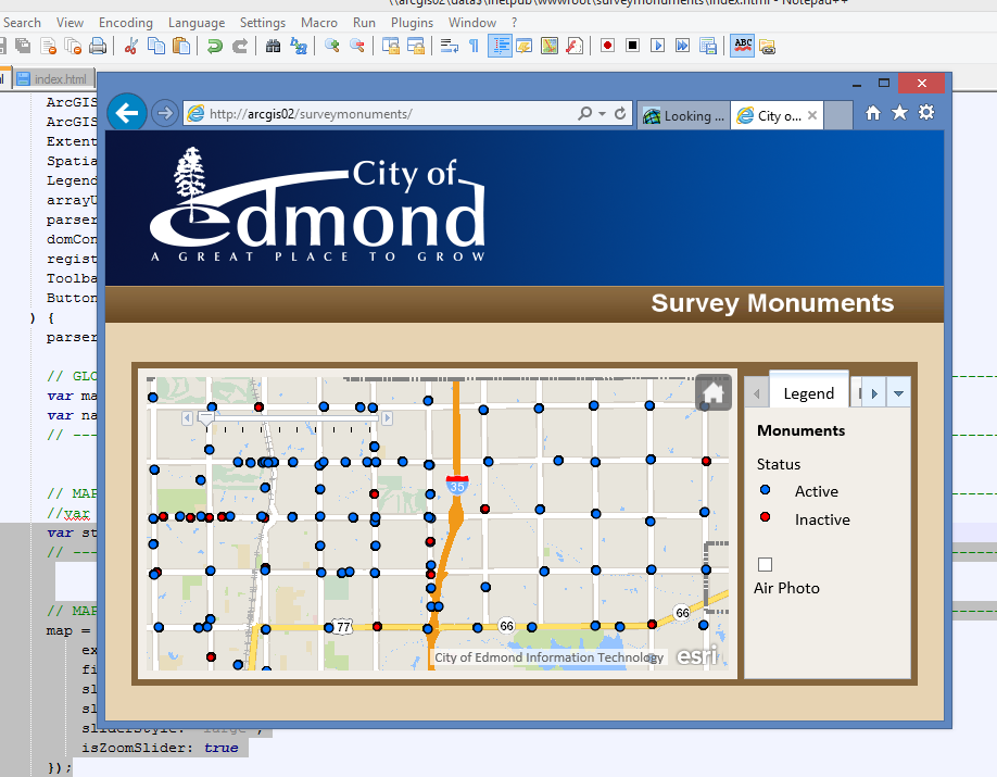

Hey Tim, thanks for the response.  I tried your suggestion, but I still do not have the map at full extent when the browser is minimized.  Here is my code and a screen shot:
   var startExtent = new Extent(2080000, 216000, 2200000, 280000, new SpatialReference({wkid: 102724}));
   // MAP
      map = new esri.Map("map", {
          extent: startExtent,
          fitExtent: true,
          sliderPosition: "top-left",
          sliderOrientation: "horizontal",
          sliderStyle: "large",
    isZoomSlider: true
Anything else I should try?
