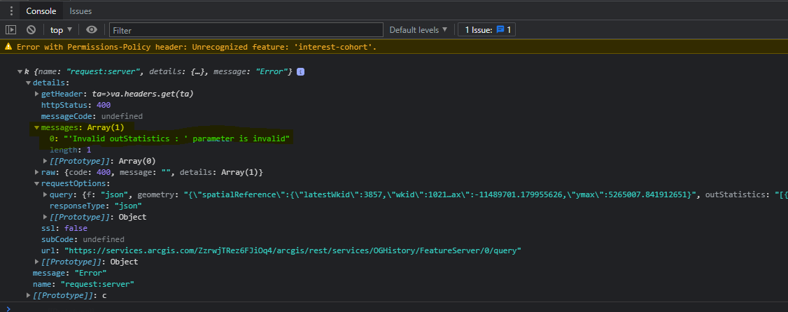

Hey there. Learning the Javascript API still and I'm trying to calculate some out statistics that then displays that info in an information box. These statistics are the GDP, Employment numbers, etc of each year for the Oil and Gas industry in Utah.
I keep getting an error related to the outStatistics when I try.
Here's the error in my console:

Any and all suggestions are much appreciated. Javascript isn't a language I am well-versed with. Still in the beginner stages of learning how it all works. Pretty good with python, so I understand the basics of loops, functions, etc.
KenBuja
MVP Esteemed Contributor
The reason you were getting an error is due to a case problem
const GDPAvg = {
  onstatisticField: "GDP_billions_", //using field name instead of field alias??? Don't know if I should. I have tried both ways now
  outStatisticFieldName: "GDP_Average",
  statisticType: "avg"
Line 2 should  be "onStatisticField"
You closed off the timeSlider watch function too early (at line 144 of your first code fragment instead of 192)
Another problem is on line 158 , which should be "features" instead of "feature"
if (result.features.length >= 1) {

    require([
      "esri/Map",
      "esri/views/MapView",
      "esri/layers/FeatureLayer",
      "esri/widgets/Expand",
      "esri/widgets/Legend",
      "esri/widgets/TimeSlider"
    ], function (Map, MapView, FeatureLayer, Expand, Legend, TimeSlider) {
      let OGLayerView;
      const layer = new FeatureLayer({
        portalItem: {
      // Create Map
      const map = new Map({
        basemap: "topo",
        layers: [layer]
      // Set the map view
      const view = new MapView({
        container: "viewDiv",
        map: map,
        center: [-111.65124179920204, 39.707361735142236],
        zoom: 7
      // Create a collapsible legend
      const legendExpand = new Expand({
        collapsedIconClass: "esri-icon-collapse",
        expandIconClass: "esri-icon-expand",
        expandTooltip: "Legend",
        view: view,
        content: new Legend({
          view: view
        expanded: false
      view.ui.add(legendExpand, "top-left");
      // Create events for the time slider
      const events = [
        { name: `Great Recession`, date: 2008 },
        { name: `Covid-19 Pandemic`, date: 2020 }
      // Create time slider with interval set to 5 years
      const timeSlider = new TimeSlider({
        container: "timeSlider",
        playRate: 750,
        stops: {
          interval: {
            value: 5,
            unit: "years"
        // time slider time extent
        //fullTimeExtent: {
        // start: new Date(1900,0,1),
        // end: new Date(2022,0,1)
        // configure ticks for dates
        tickConfigs: [{
          mode: "position",
          values: [
            new Date(1900, 0, 1), new Date(1910, 0, 1), new Date(1920, 0, 1), new Date(1930, 0, 1), new Date(1940, 0, 1), new Date(1950, 0, 1), new Date(1960, 0, 1), new Date(1970, 0, 1),
            new Date(1980, 0, 1), new Date(1990, 0, 1), new Date(2000, 0, 1), new Date(2010, 0, 1), new Date(2020, 0, 1)
          ].map((date) => date.getTime()),
          labelsVisible: true,
          labelFormatFunction: (value) => {
            const date = new Date(value);
            return `${date.getUTCFullYear()}`;
          tickCreatedFunction: (value, tickElement, labelElement) => {
            tickElement.classList.add("custom-ticks2");
            labelElement.classList.add("custom-labels2");
          mode: "position",
          values: events
            .map((event) => new Date(event.date, 0, 1))
            const event = events.find(
              (s) => new Date(s.date, 0, 1).getTime() === value
            return event.name;
            tickElement.classList.add("custom-ticks");
            labelElement.classList.add("custom-labels");
      // add time slider to view
      view.ui.add(timeSlider);
      // Creating view layer???
      view.whenLayerView(layer).then((layerView) => {
        OGLayerView = layerView;
        // Setting start date for time slider
        const start = new Date(1900, 0, 1);
        // Extent for time Slider
        timeSlider.fullTimeExtent = {
          start: start,
          end: layer.timeInfo.fullTimeExtent.end
        // Show 5 year intervals
        let end = new Date(start);
        end.setDate(end.getDate() + 1825); // the number here is in days (1825 = 5 years)
        timeSlider.timeExtent = { start, end };
      // watch timeslider timeExtent change
      timeSlider.watch("timeExtent", () => {
        //oil wells that popped up before the end of the current time extent
        OGLayerView.filter = {
          where: "OrigComplDate <=" + timeSlider.timeExtent.end.getTime(),
        // add grayscale effect to old wells (may or may not keep this)
        OGLayerView.effect = {
          filter: {
            timeExtent: timeSlider.timeExtent,
            geometry: view.extent
          excludedEffect: "grayscale(80%) opacity(20%)"
        // Run statistics for GDP within current time extent
        const statQuery = OGLayerView.effect.filter.createQuery();
        statQuery.outStatistics = [
          GDPAvg
        layer.queryFeatures(statQuery).then((result) => {
          let htmls = [];
          statsDiv.innerHTML = "";
          if (result.error) {
            return result.error;
          } else {
              const attributes = result.features[0].attributes;
              for (stat in statsFields) {
                if (attributes[name] && attributes[name] != null) {
                  const html =
                    "<br/>" +
                    statsFields[name] +
                    ": <b><span>" + // setting bolding and styling
                    attributes[name].toFixed(0) + // How many decimal places
                    "</span></b>"; // setting bolding and styling to attribute information
                  htmls.push(html) // push html into code into information box with attribute information
              const yearHtml =
                "<span>" +
                result.features[0].attributes["GDP_Average"] +
                "</span> billion dollars was added to Utah's GDP by the Oil and Gas Industry between" +
                timeSlider.timeExtent.start.toLocaleDateString() +
                " and " +
                timeSlider.timeExtent.end.toLocaleDateString() +
                ".<br/>";
              if (htmls[0] == undefined) {
                statsDiv.innerHTML = yearHtml;
              } else {
                  yearHtml + htmls[0];
          .catch((error) => {
            console.log(error);
        const GDPAvg = {
          onStatisticField: "GDP_billions_", //using field name instead of field alias??? Don't know if I should. I have tried both ways now
        const statsFields = {
          GDP_Average: "GDP Average"
      const statsDiv = document.getElementById("statsDiv");
      const infoDiv = document.getElementById("infoDiv");
      const infoDivExpand = new Expand({
        expandTooltip: "Expand Oil and Gas Industry info",
        view: view,
        content: infoDiv,
        expanded: true
      view.ui.add(infoDivExpand, "top-right");

cschooley
Thank you.
I need to take some more time reading through my code for the little case and spelling errors like that. I wrote and rewrote the code, trying to understand how it was working (versus just copy and pasting). I think I got tunnel-visioned.
And thanks for the note on closing the timeSlider. The opening and closing of blocks still confuse me a bit.
This worked for me, after making those changes. You are still getting a null value because, in my data, I don't have GDP data until about 1967. I'm still tracking down earlier data in data archives, non-digital ones. If you hit play on the timeSlider, around the 1960s the statistics start to show up.
KenBuja
There's also a mistake on Line 269.
but you're using "name" in the loop
cschooley
Thank you. I just caught that one.
KenBuja
And once I let it run to the end, I got the statistics showing up. You should format that statistic so you don't get "943.345425518852 billion dollars"
cschooley
I just added a .toFixed() into the code to help with that.

  outStatisticFieldName: "Employment_Count",
const wellCounts = {
  onStatisticField: "API",
  outStatisticFieldName: "Well_Counts",
  statisticType: "count"
        view: view,
        content: infoDiv,
        expanded: true
Any help is appreciated. Thanks!
