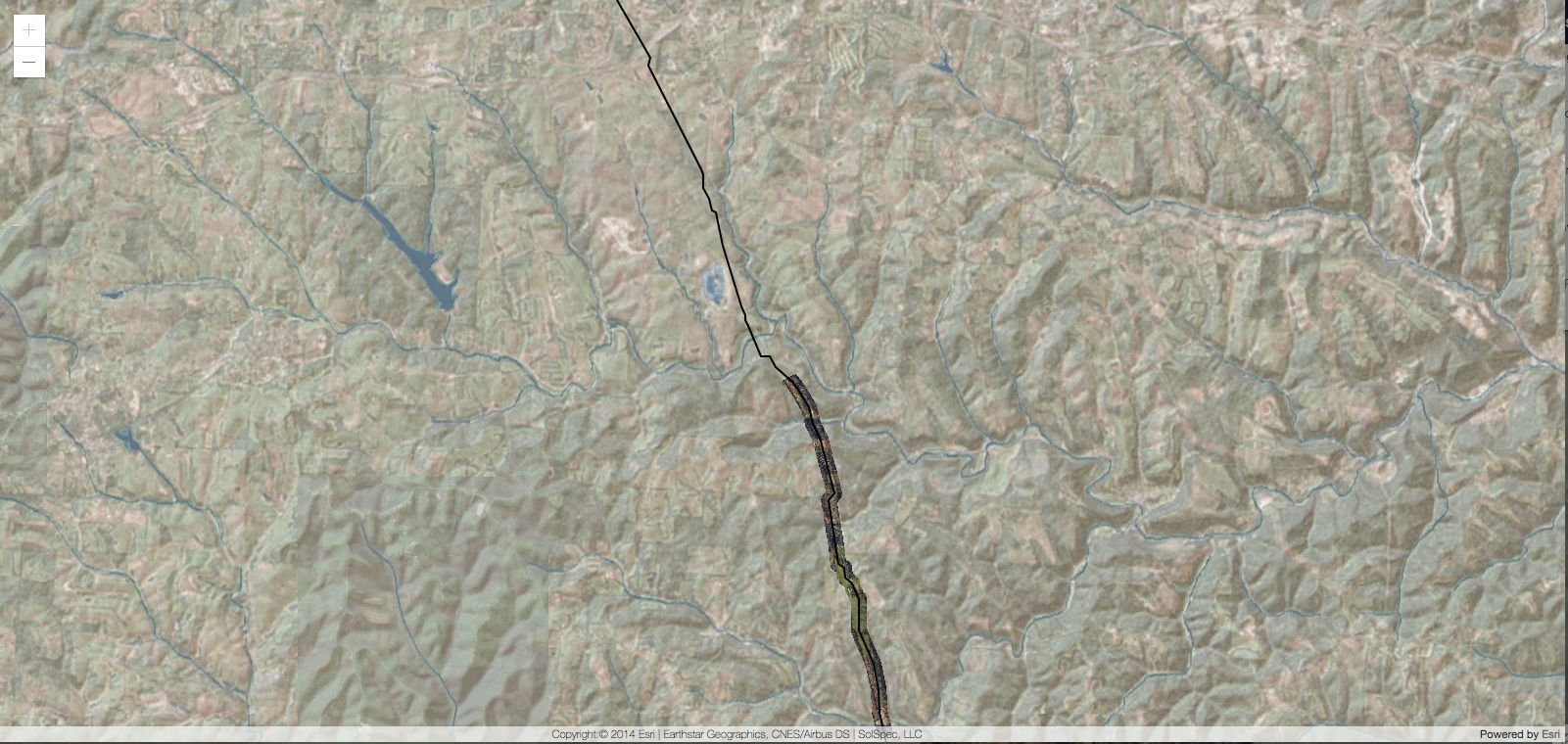

Here is an example of what the 2D map looks like (only one raster item from the service is turned on):

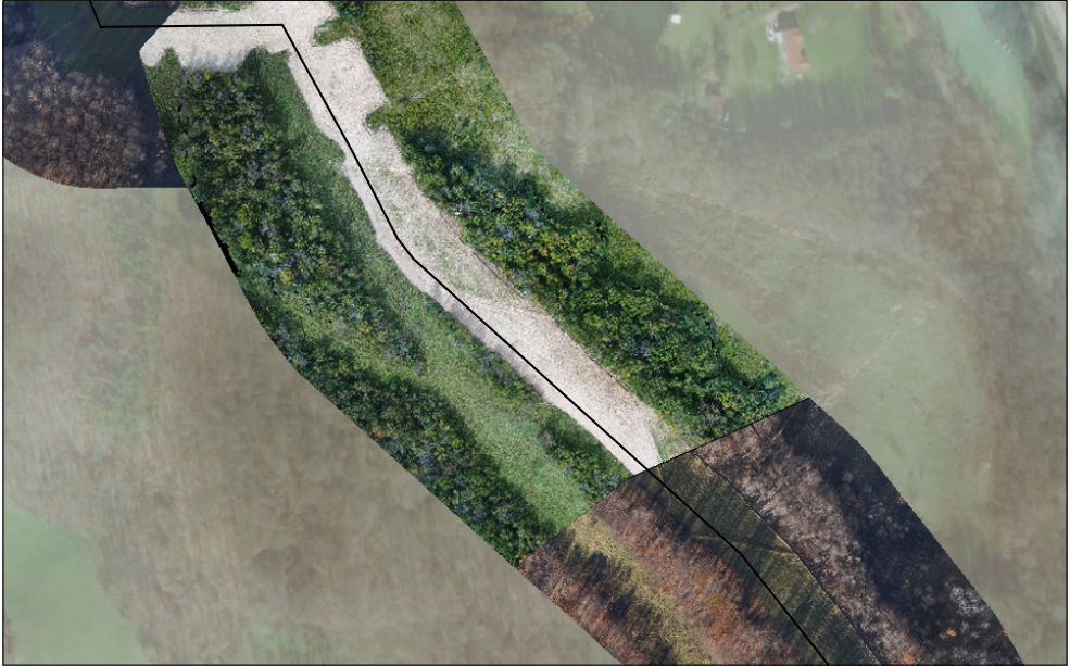

This is what I get in the print result (don't mind the different zoom level, it's the same map):
if the image does not appear below, please refresh
- We would expect the above image to only be showing the imagery that begins in the bottom right corner, up until it meets the imagery with more green vegetation in the center. The imagery in the top left corner is not the same raster item as the bottom right, and shouldn't be showing either.
Has anyone else been able to successfully execute a print in the 4.x API that honors an image service layer's mosaic rule?
