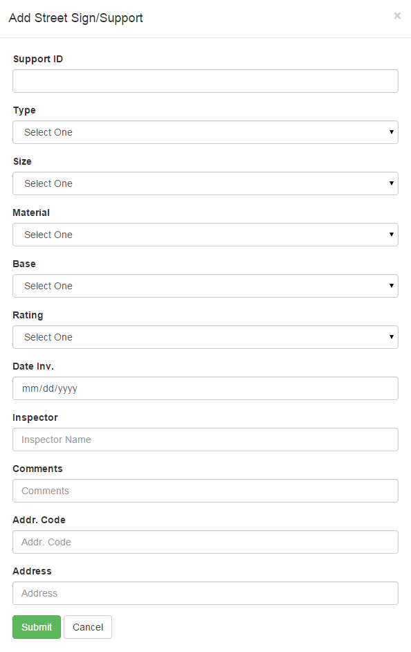

In this example a supportId of 691 is selected. I have a form that I want to update only one set of values at at time, so how do get just the name;
SIGNID  and the value of 1169 so that I may set SIGNID's value to 1169 on the form. I basically want to update my form with all the values in the first element of the array, but I am not sure how to select JSON items. The following items are in my array and I will want to replace each as the user click previous or next.

This helps if I want to manually enter information in. I figured out what I needed to do. I needed to return the attr which is the attribute or name and the feature attribute which is the value of the attribute. I used the following code to do this:
console.log("Attribute: " + attr);
console.log("Feature Attribue: " + featureAttributes[attr]);
