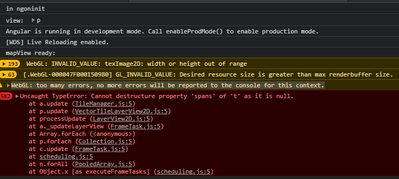

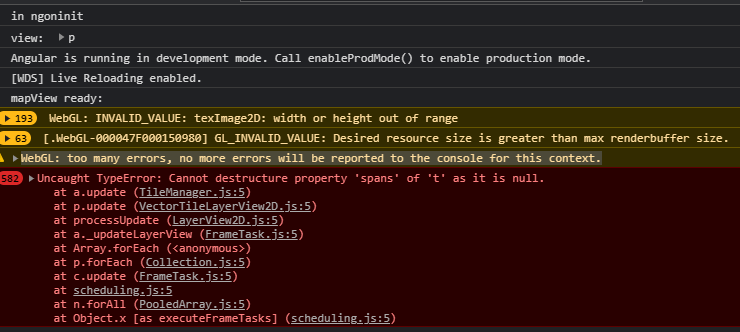

I'm trying to get a sample working of our map component library (originally done in Angular 9 and using esri-loader). For now, I have the code from the Intro to MapView - Create a 2D map sample hardcoded into the library.  When I run the app locally (built library and ng serve), I get an automatic scroll of the map. The console also shows WebGL errors. Any ideas what's causing this?

@AndyGupThis is where it gets interesting: I copied the map and view into the jsapi-resources sample and it worked. I tried it again in my library/test app and got the same issue (autoscrolling and WebGL errors in console).
