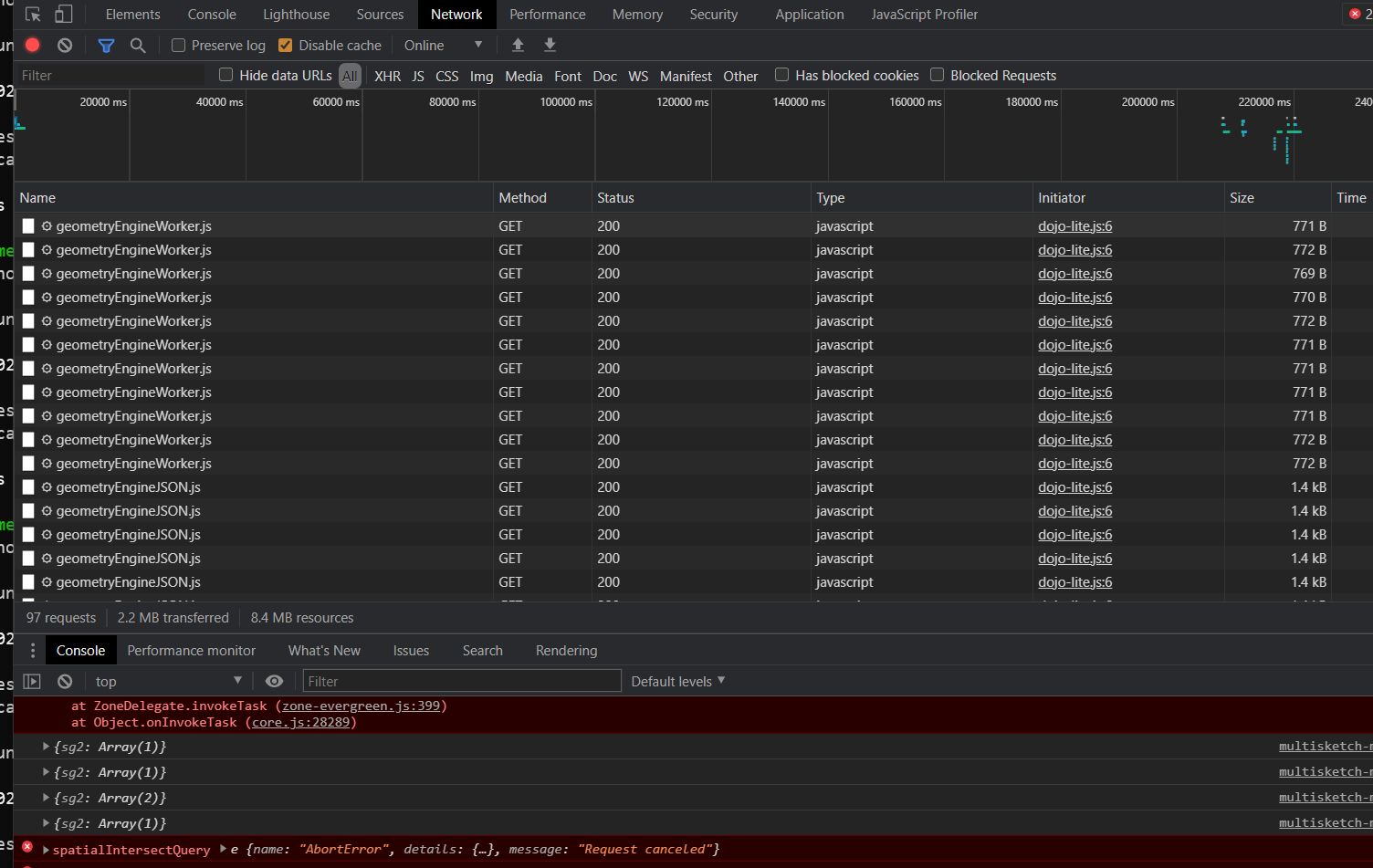

I do believe that I am calling loadModules on the initialization of my component, which is when the geometryEngine*.js scripts are added. However it appears that the worker threads don't get hydrated with the geometryEngineWorker.js scripts until the union method is invoked. Check out the waterfall here:
With fresh eyes, it seems like calling the method on an empty array after the geometryEngineAsync has loaded is giving me the desired result... The threads are loaded and ready to rip by the time the user would get around to interacting with the map.
Is there any reason not to do this?
