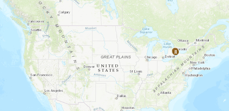

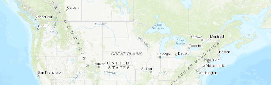

Is it possible to change the polygon / polyline size based on zoom?  When I have points and I zoom out they're still visible, but when I have polygons / polylines they disappear when I zoom out, which is no ideal, as I have data spread over Canada.
vs
At this zoom level the polygon data should appear by Toronto, and get more accurate when we zoom in.
