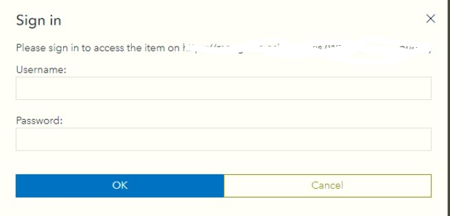

Hi All,
I am using custom base map into my application , but the application is prompting to enter the credentials. I want avoid the login window and pass the credentials in the code itself. Kindly suggest me the idea.
