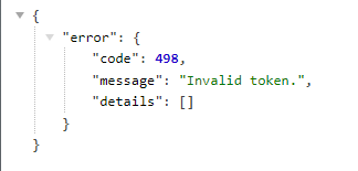

I'm receiving an error when providing an API Key using the JS SDK version 4.27. Same behavior for 4.25. This had previously been working:
loadModules([
    'esri/config',
    'esri/Map',
    'esri/views/MapView',
]).then(([esriConfig, Map, MapView]) => {
    esriConfig.apiKey = 'xxxxx';
    const map = new Map({
        basemap: 'topo-vector',
    const view = new MapView({
        viewDiv: 'test',
        map: map
Obviously, substituting our actual API key for 'xxxxx'. This is hitting the following URL:
https://cdn.arcgis.com/sharing/rest/content/items/7dc6cea0b1764a1f9af2e679f642f0f5/resources/styles/...
Without providing an API key, it works.
This had been working previously, as my developer account has historical usage. I've also tested a different API key and receive the same error. Structurally there's not much else going on in the code, and it's the same approach mentioned by official documentation: https://developers.arcgis.com/javascript/latest/tutorials/display-a-map/

roberth
Lo and behold it works now. I think it was just a temporary service disruption.
LaurenBoyd
Glad to hear it works now! That is possible it could have been a service issue.

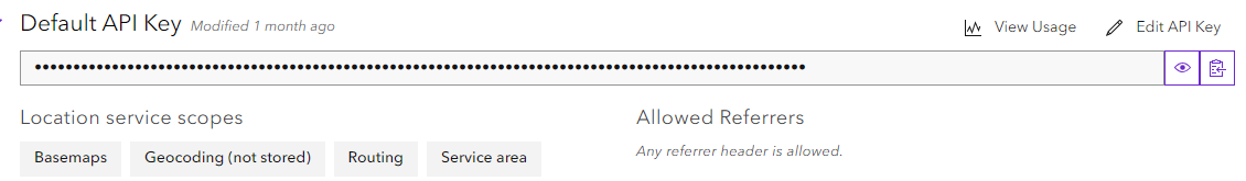

Noah-Sager
That's very strange. It sounds like something happened to the API Key. I would try making a new one and testing it out. The workflow still works (I just checked). But I would also recommend not using an API Key in the app if it's not needed.
