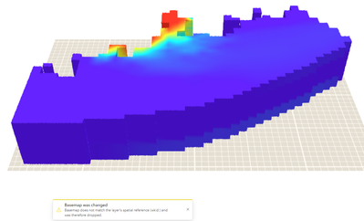

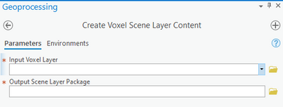

1st method:  I used GP tool "Create Voxel Scene Layer Content" to create a local .slpk file. Then I add the local slpk file to AGOL and make a hoisted scene layer.
Result: It dropped my base map even through even through its xy coord system is WGS1984 web.

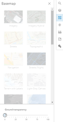

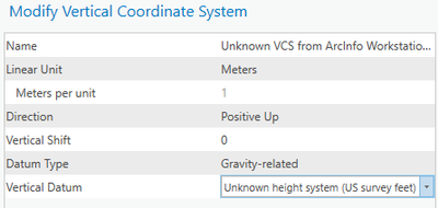

 I think the problem is the strange vertical coordinate system in voxel layer in ArcGIS online
I can't even add base map to it. It is grey! I also cannot change the vertical coordination system for the voxel in ArcGIS Online.

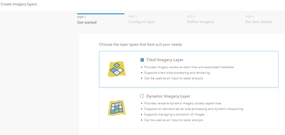

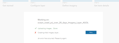

3rd method:  On ArcGIS Online, add Imagery layer and choose tiled imagery Layer
choose mosaicked image
Choose my netCDF file and proceed.
Result: Creation failed
I have succeed in making uv flow diagram using crf and import it as ArcGIS Online.
However, it failed for netCDF.

The Scene Viewer requires all cached layers to have both the same horizontal coordinate system as well as vertical coordinate system. Since the basemaps do not have the same vertical coordinate system as the voxel layer they are dropped automatically. What I would do is create a projection file with just the Web Mercator horizontal coordinate system and place it in next to the netCDF file in the file system. This will override the netCDF coordinate system so when you re-add the netCDF as a voxel layer you should see no VCS. From there you can then create the voxel scene layer package and publish it as a voxel scene layer. Regarding the time slider, this is not available in the Scene Viewer.
