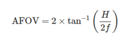

I solved this by using the camera properties tool under the view tab, navigation section. I left the fields "X", "Y", "Z", "Pitch", "Roll", and "Heading" with their auto-filled values based on the observer point I zoomed to using the Line of Sight tool above. The final field, "Field of View" is where the focal length of the camera gets incorporated. The equation I used for Field of View (AFOV) is:
Where f = focal length and H = the sensor size of the camera.
