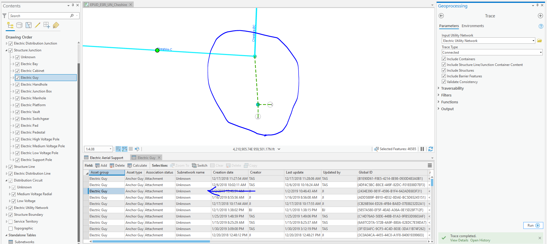

Hello,
I'm having an issue running Pro 3.3 with 3.3 patches and 10.6. I have a Utility Network and none of the Anchor Guy features will update with a subnetwork. All Anchor Guys have Structural Attachment associations with the poles they are on. The Poles all update with a subnetwork but the Anchor Guy features associated with them will not. I have verified that Structural Attachment Rules exist for all Pole Asset Types and the Anchor Guy Asset Type.
Any help would be appreciated.
Thanks,
