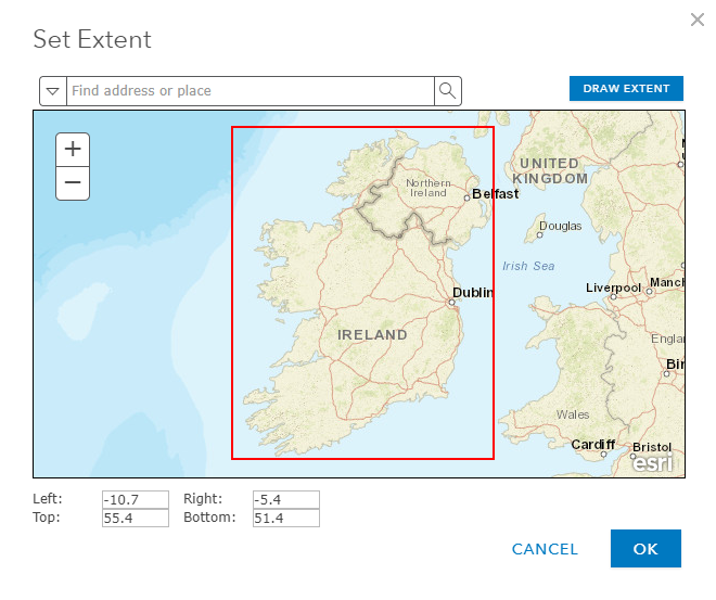

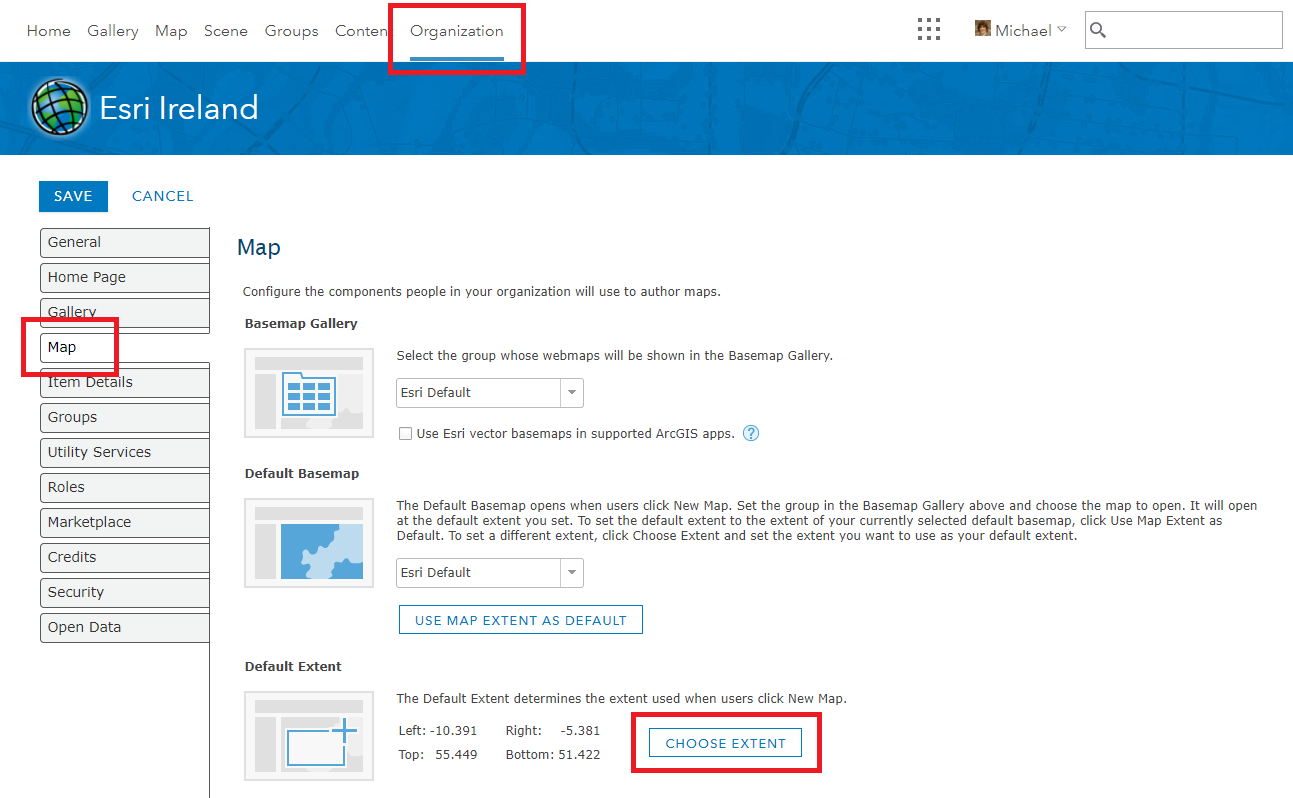

A good way to do this is to go to your organisations settings. Go to your Organisation - Edit Settings - Map and click Choose Extent as below.
From there, you can a Draw an extent, and note down the Lat/Long values you will need to use in your survey. The values below correspond to the values used in the attached form, so you can directly replace them as necessary.
The alternative is to use the super-useful Super-Duper Extent Helper developed by Bradley Snider.
