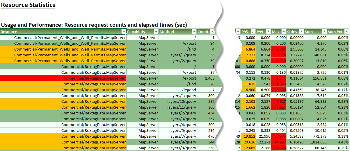

We're going to focus on 2 key statistics, P95 and Max. As we learned above, P95 signifies the response time for the fastest 95% of all requests and Max signifies the maximum draw time per request per service and method.
Identifying Opportunities to Tune Service Performance

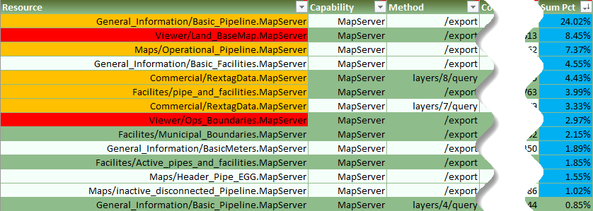

In the example below, I've sorted P95 and Max values over 1/2 second. User experience drops the longer your draw-time takes.
I've highlighted any Max draw time over 1/2 second in red and any P95 draw time over 1/2 second in yellow. These are the services and layers I'd focus on cleaning up, focusing first on getting the P95 value below 1/2 second first.
In the next section you'll find starting points to tune and optimize your services.
Another column worth reviewing is the Sum Pct. this column factors in the number of requests for each service and the respective average time, then weights that in against all the other services.
For example:
- One service may have thousands of more requests than all others but it has fast times (Sum Pct should be low)
- Another service may have just a small handful of requests but very slow times (Sum Pct should be high). In this case, this service would be a good candidate to for tuning.
