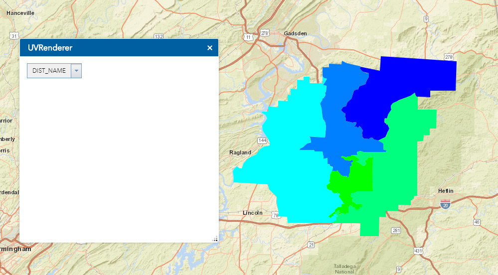

Abhinav,
  So like I said I tested this and it worked fine for me using my service url. So the next question is are you using the right symbol type? The code is setup to symbolize a Polygon feature.

AbhinavSharma
Deactivated User
Yeah i have a regular feature layer (not a dynamic layer or anything) that is a polygon feature. with full control over the polygon.

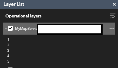

AbhinavSharma
Deactivated User
I think what is happening that the renderer is not attaching the symbols to the values (hopefully I worded that correctly)
here is an example of the legend after setting the renderer.
those are the correct values for the field i have chosen but they are given a null symbol. I don't see why it would do that for my feature layer but not for your feature layer.
KisakyeM
Regular Contributor
I too downloaded @RobertScheitlin__GISP 's attached widget code and my results are similar to yours. The values for the field are shown but the symbols are not.
