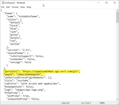

Remember you will need to set appID in config.json of the deployed app downloaded from WAB dev edition. You should first register your app on the Portal where the map source is from, and then copy the App ID to update the config.json.
Could you try again?

(thanks for pointing to the need to set correctly the "appId" config variable. I knew to do it, but, as I said, I was misleaded by the extra dialog box and have not noticed that the SAML login works no OK).
