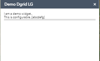

LaurynasGedminas2
Hey Robert, @RobertScheitlin__GISP
trying to deploy this widget or the ArtList widget, i and get blank  gray space for the dgrid.
my html is <div data-dojo-attach-point="grid2" style="height: 100%"></div>
what is the issue here
MVP Emeritus
It appears you have missed something in your code I would have to see your Widget.js
LaurynasGedminas2
here is the ArtList widget
