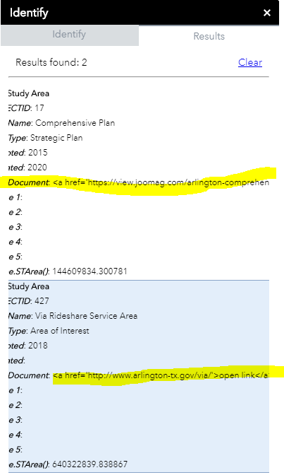

Hello Robert,
After applying your latest the code suggestion, the content is changed. But the identified panel doesn't render the hyper link - but the source code. Thanks

Helen,
  in the List.js find and this
attTitle.textContent = attTitle.innerText = attValArr[0].replace(/<[\/]{0,1}(em|EM|strong|STRONG|font|FONT|u|U)[^><]*>/g, "";
and replace with:
attTitle.textContent = attTitle.innerText = attValArr[0].replace(/<[\/]{0,1}(em|EM|strong|STRONG|font|FONT|u|U)[^><]*>/g, "") + ": ";
Then find:
          if (attValArr[1] === 'null') {
            attVal.textContent = attVal.innerText = ": ";
          } else {
            attVal.textContent = attVal.innerText = ": " + attValArr[1].replace(/<[\/]{0,1}(em|EM|strong|STRONG|font|FONT|u|U)[^><]*>/g, "");
          domConstruct.place(attTitle, label);
          domConstruct.place(attVal, label);
          domConstruct.place(label, div);‍‍‍‍‍‍‍‍‍‍‍‍‍‍
and replace with:
          } else {
            var innerCont = domConstruct.toDom(attValArr[1].replace(/<[\/]{0,1}(em|EM|strong|STRONG|font|FONT|u|U)[^><]*>/g, ""));
            domConstruct.place(innerCont, label);
          //domConstruct.place(attTitle, label);
          //domConstruct.place(attVal, label);‍‍‍‍‍‍‍‍‍‍‍‍‍‍‍‍‍‍‍‍‍‍‍
          domConstruct.place(label, div);‍‍‍‍‍‍‍‍‍‍‍‍‍‍‍‍‍‍‍‍‍‍
In the Widget.js replace your  if statement with this:
if (value.toLowerCase().indexOf("http") > -1) {
  value = "<a href='" + value + "' target='_blank'>" + value + "</a>";
The target _blank is the important part.

Hello Robert,
I have applied the codes. It works. To make the field value short, I change the code to
                        value = "<a href='" + value + "' target='_blank'>" + "Open Link" + "</a>";
I will do more testing, making sure other functions in the identify widget will stay functional.
