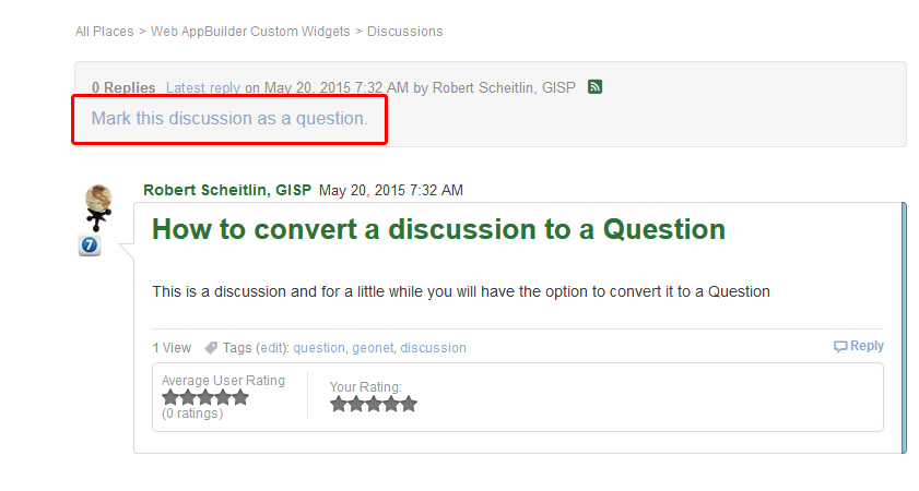

BrandonKeinath1
Deactivated User
Thanks Robert,
How did you convert it to a question?  When I edited the discussion I didn't see it as an option.  I could have missed it though.
Brandon
RobertScheitlin__GISP
MVP Emeritus
Brandon,
   At the very top of the page there is a link for that.
