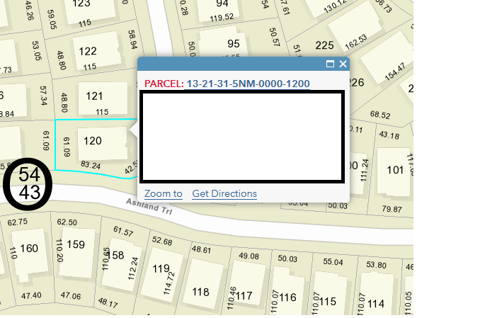

I am working with wab 2.9 javascript and encountered a strange issue someone may have already dealt with.
Using the simple "ID" functionality, I get the infowindow pop-up from map hosted in AGOL, but the graphic (teal outline) does not match the geometry of the parcel polygon clicked on ???  see pic
At a loss on what and/or why is causing this.Robert Scheitlin, GISP

I am looking into this. The issue is that your web map has the parcels layer as a ArcGISDynamicMapServiceLayer and not a FeatureLayer Like I was thinking. I will continue to look for a solution.

Is the popup (simple Id) coming from the web map for that layer or are you using some widget to produce that layer?
WilliamBailey
The pop-up is coming from the web map and this odd geometry occurrence does not happen there. (see pic)
