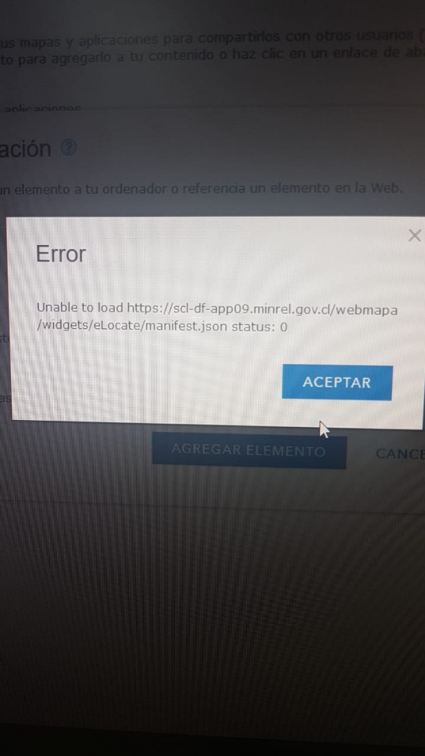

Hi,
I'm trying to register a widget in the portal but it gives me an error.
Can you help me with this?

Maria,
  Portal 10.5.1 uses WAB 2.4 so you need to register the 2.4 version of the eLocate widget on the 2.9.x version.

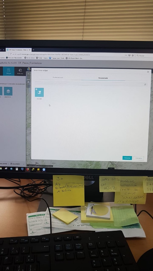

Maria_ElenaPezoa
... I changed the version and I could read the widget without problems,....  however I can not or will not let me add it to my template ......
Why does this happen if everything up to this point worked ok?
thanks in advance...
Maria_ElenaPezoa
