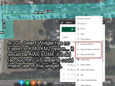

by Anonymous User
Not applicable
It would be super nice if AGOL Select Widget allowed exporting to KML/KMZ. Current options still do not include this. We would like for our non-GIS expert end-users to be able to select features and export them to KML/KMZ.
