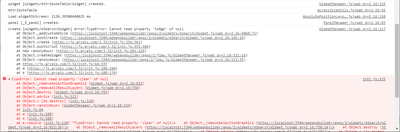

@RobertScheitlin__GISPJust to follow up:
Widget.js
_addCustomStyle: function(theme) {
var customStyles = lang.getObject('customStyles', false, theme);
if(!customStyles || !customStyles.mainBackgroundColor || customStyles.mainBackgroundColor === ""){
return;
var rgbArray = Color.fromHex(customStyles.mainBackgroundColor).toRgb();
The best I can tell the"var rgbArray =" line appears to be throwing the error so I added a "return;" statement prior to this line and everything started working.
