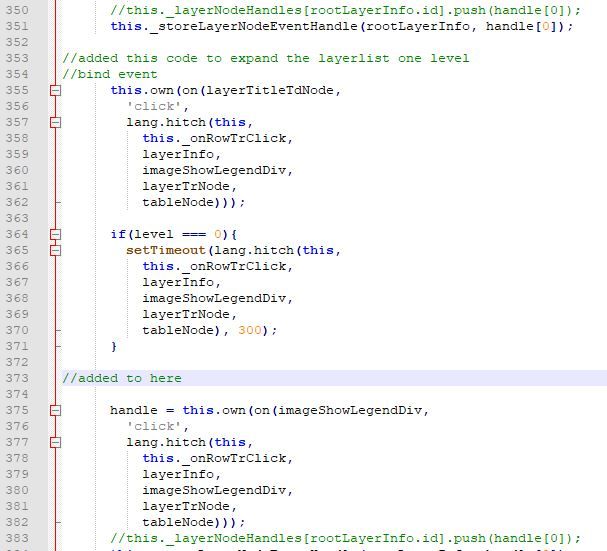

MatthewFletcher
This still works in V2.20, add the code after line 351.
