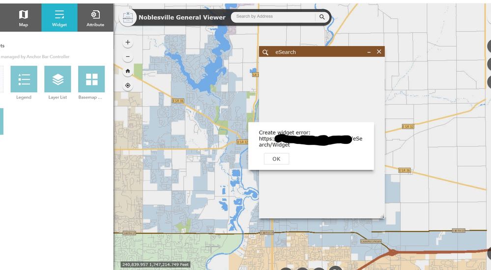

I'm currently using Portal 10.8.1 and tried to install eSearch Widget version 2.17 and encountered the following error?  I have used this widget before (not this version and not this version of Portal) and haven't encountered an error like this.  I also use the eDraw and Print Plus widgets and have no problems with those.  Any ideas?  ThanksInkedcreatewidgeterror_LI.jpg

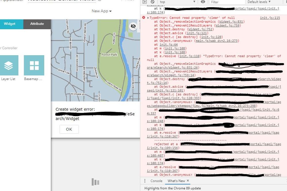

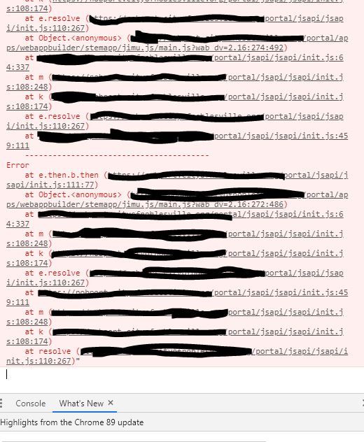

   What errors do you see in the web browsers console?
RickEhlin__Jr

   I have not seen this or have anyone report this so far. I am not to sure why it is happen either but this change to the widget.js file should resolve the issue.
      _removeSelectionGraphics: function () { //Line 831
        this.selectionGL && this.selectionGL.clear();
