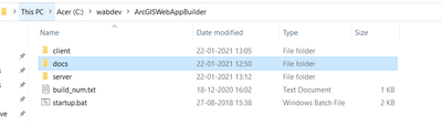

I believe the "~/docs" folder referred here is under ArcGISWebAppBuilder directory (Unzipped from the WAB-Dev Edition zip file).
