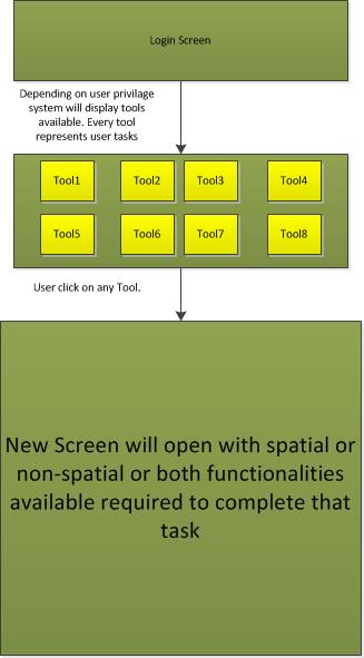

We are intending to build enterprise Arcgis application based (Widget based+Arcgis Java script+Arcgis server 10.2+ MS SQL server). It will contain tools for reporting , editing data, analysis, decision making, data validation.
Application will contain users with certain roles (abitlity to use tools and data based on role and permission)
We have both spatial and non-spatial functionalities.

The high end design of the appplication is in attached image.

Shafi,
As there is no build in reporting capabilities just in the ArcGIS JavaScript API, you would need to use .net reporting capabilities like you mention along with JS api.
The question of using the WAB is very dependent on your UI requirements, timeline, etc. If you are not wanting to spend a lot of time on your apps UI and want to use something that is already built for you then WAB is good if your time line can wait for the WAB to be released. Currently the WAB is only in beta and  beta licensing does not allow for its use in production applications.
