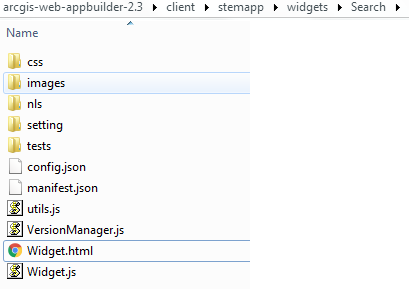

KrishV
You can find Search widget as shown in below screenshot:

GilbertoMatos
Hello Friend!
Thanks for the help, but what I need to know is the dijit template. This html file contains a basic search structure, but what I need is a point where you find a structure with the search field, button, and so on.

RobertScheitlin__GISP
MVP Emeritus
The search Fujitsu is part of the JS API so you will not find that in the WAB source code. You will only be able to modify by CSS.
