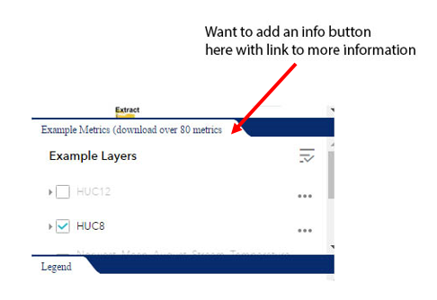

DianeWhited
Robert,
See image below.  I have the layerlist widget open in the sidebar.  I would like to add image and link along side the label.
Hope this clarifies things.  Thanks,
Diane
RobertScheitlin__GISP
MVP Emeritus
Diane,
   That would take a good deal of code to customize that theme to allow for that.
