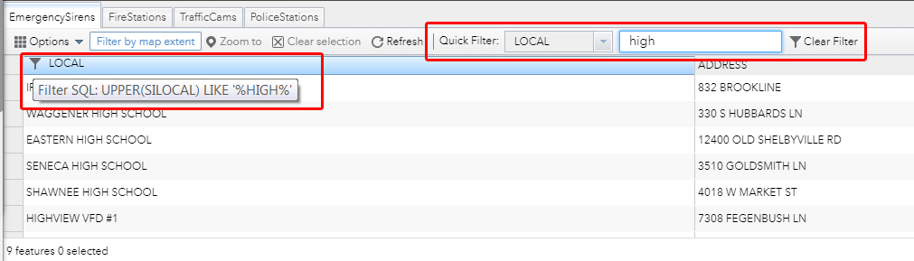

RobertScheitlin__GISP
MVP Emeritus
Lefteris,
   This is what I am liking now (cleaner UI/UX feel). Filter icon does not get applied till the table is actually filtered and it persists when the table is refreshed.

LefterisKoumis
Robert, I'd like to thank you for your time and effort to assist me with this effort.
I finally realized why the map kept refreshing when I was clicking on the column header at first, then at the select drop down. Because of  stupidity, I didn't realized that by initializing the textbox,  every time I was selecting another field, I was re-initiating the query of the fields.
this.thetextbox.set("value", "")
What I should have done is that I could keep this line but also use
if(filter_name && filter_name !== ""){
Anyway, your code is very helpful to understand, among other things, of how to change the default stylesheetsof WAB widgets for a target element.
