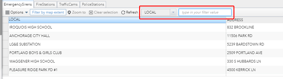

LefterisKoumis
That's correct.That's why I moved away from clicking the header because the map refreshes after you click the header. It has to do the js api, that triggers refresh.
Then I moved to the dropdown as you show on the screenshot.
My goal here is multiple columns filtering. So after a field is filtered, and the map shows the results, then user select another column to filter the current features on the map. I know how to do this however, if the map is refreshed every time I apply the filtering, the results are gone.  I applied the th css rule, so when a user select a value from the dropdown, then the header for the field changes color. However, as the user select more fields, I want the original filed to maintain the custom th color, so user has a visual of which columns he/she filtered so far. Hope it makes sense.
So, the two issues are to  stop the map refershes everytime you click on the drop down and the custom th color tpo remain on the previous field you selected after you select another one. The clip shows another select dropdown, you can ignore that. I will use it after I resolve these issues. Thank you.
(view in My Videos)
RobertScheitlin__GISP
MVP Emeritus
Lefteris,
  The way the logic is right now for the filtering you can not filter one field and then filter another without overriding the first filter... So I am not sure if your workflow is even possible.
