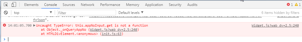

Attempting to build a new widget and having difficulty acquiring the value found in a textbox control in the widget.html and getting the error: "this.<name>.get is not a function".  Hopefully I'm just missing the obvious.  And thanks to Robert and this group for the jumpstart!

var appNo = this.appNoInput.get("value");
//generates the error "this.appNoInput.get is not a function"

Agreed, there's only a couple of references to that function so I can eliminate it.
I'm back to the original uncaught TypeError: this.appNoInput.get is not a function
_onQueryAppNo: function() {
       //  summary:
       //      When an application is queried via the widget,
       //      this function begins look up tasks.
       this.resetForm();
       var appNo = this.appNoInput.get("value");  //error occurs here
       console.log('_onQueryAppNo value: ', appNo);
       var query = new Query();
       query.where = "APP_NO = '" + appNo + "'";
       query.outFields = ["*"];
       this.queryTask.execute(query).then(lang.hitch(this, this._populateForm));

James,
  So here is your Widget.js working now. Sometimes very simple things that are not obvious can get you and your case was the BaseWidget has to be listed before _WidgetsInTemplateMixin in the declare array:
