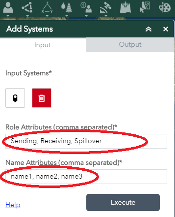

Hello,
I am trying to customize my WAB-templated app by using some placeholder values to be seen by users in the appropriate text space for widget parameters. Specifically, instead of having a "defaultValue" set inside the widget config_widgetname.json file like I do now, I would like to have true placeholder labels. Could you point me to the correct file/parameters where I can customize and add these?

I am basically trying to locate where the placeholder string parameter value is, since I have several GP widgets like that and would like to replace the "defaultValue" with traditional placeholder text (greyed out and disappearing when the user clicks inside the text space to type a value)...

   So that is a GP widget? Most likely the widget is not setup to have a placeholder string. So if the widget currently is setting the inputs value with a string configured in the widgets json then you just have to find in the widget source code where that is happening and instead of setting the inputs value set the placeHolder instead.
FrancescoTonini2
Correct, these are all GP widgets from WAB to which I gave a different name (and settings) for my web app. I was afraid the issue was the GP widget itself not having such a parameter set up. Currently, the GP widget uses the "defaultValue" parameter inside the corresponding ~\configs\Geoprocessing\config_<widget name>.json file and uses that to set up default values to be passed to the GP service once the user clicks on "Execute". I would simply like to remove any default value and instead have a placeholder greyed out value (like it's now for the Search widget or the Geocoding widgets for example). What do you mean by setting the "placeHolder" inside the widget source code? You mean look inside the ~\widgets\Geoprocessing\Widget.js file or inside the ~\configs\Geoprocessing\config_<widget name>.json file? Is placeHolder a variable name you picked or an existing parameter name I can add?

   I see no need to modify anything in the Widget.html, actually you are not likely to modify the Widget.js. In the GP widget its UI is built dynamically based on the GP Service needs. It will likely be the editors folder and the specific editor like the simpleEditors.js for a linearUnit.
  mo.LinerUnitEditor = declare(BaseEditor, {
    baseClass: 'jimu-gp-editor-base jimu-gp-editor-liner-unit',
    editorName: 'LinerUnitEditor',
    postCreate: function(){
      this.inherited(arguments);
      this.distance = this.param.defaultValue ? this.param.defaultValue.distance : 0;
      this.units = this.param.defaultValue ? this.param.defaultValue.units : 'esriMeters';
      this.inputDijit = new NumberTextBox({value: this.distance});
Notice on line 10 below the value of the NumberTextBox is populated with the this.param.defaultValue.
So you would want to change that to:
this.inputDijit = new NumberTextBox({placeHolder: this.distance});
