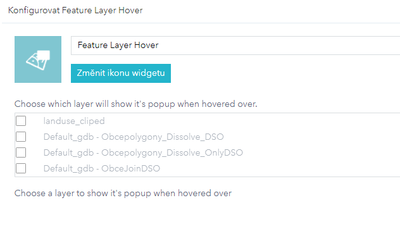

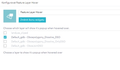

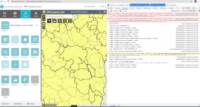

Hello @RobertScheitlin__GISP,
I use WebAppBuilder version 2.22, other custom widgets work but FLHover not. The widget is visible but doesn't respond. In settings I check FL but it doesn't save. I've noticed it should be fixed so the mistake must be on my side. Could you give me any advice?
I've attached some screenshots.

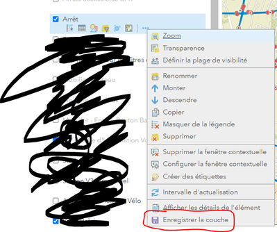

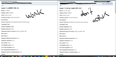

Hi @RobertScheitlin__GISP ,
i used your custom widget and it works great. But I'm creating new apps and I don't know the widget doesn't want to work anymore. I'm still with featureLayer so I don't understand.
What's your advice?
Other information, there is nothing on the console.
Thank you Robert
MVP Emeritus
@KARIMLABIDI does the FL that does not work have a popup defined in the webmap? Is the popup using Arcade?
KARIMLABIDI
Hello Robert,
I saved the FL in my webmap and now it works on this new FL.
Yes the pop up use Arcade.
It's little bit strange but the main thing that it works!
