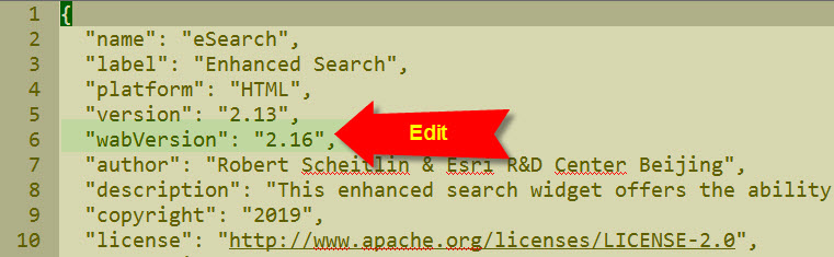

The new release of the Developer Edition of the Web AppBuilder 2.16 (April 2020) did not break any of your Custom Widgets.
All your Custom Widgets are working flawlessly.
I updated the Parcel Map to test out everything:
http://www.davidapps.net/maps/phones/app284/
The only change I had to do was edit the manifest.json file under each widget and change the wabVersion to 2.16
  "wabVersion": "2.16",
