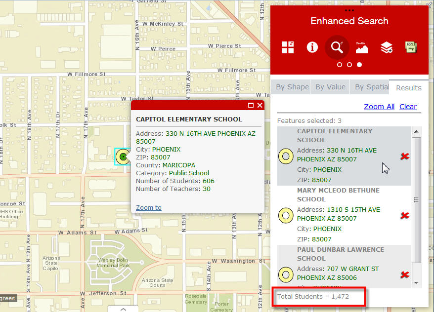

ZhujingXia
Robert,
In your result of the eSearch, you show the field name as font style italic, how you do that? Where did you set up the style in the css file?
Thanks
Zhujing
RobertScheitlin__GISP
MVP Emeritus
Zhujing,
  That is controlled by the result format GUI in the widgets settings dialog.

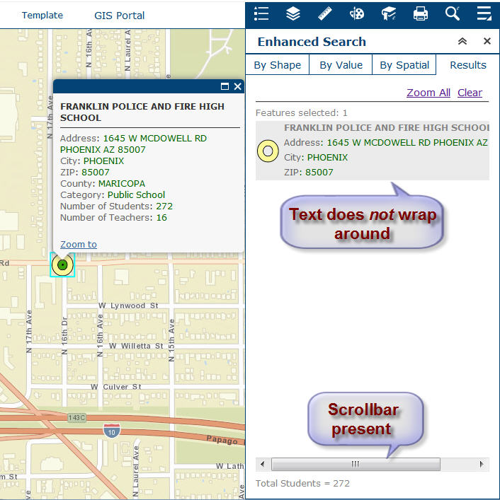

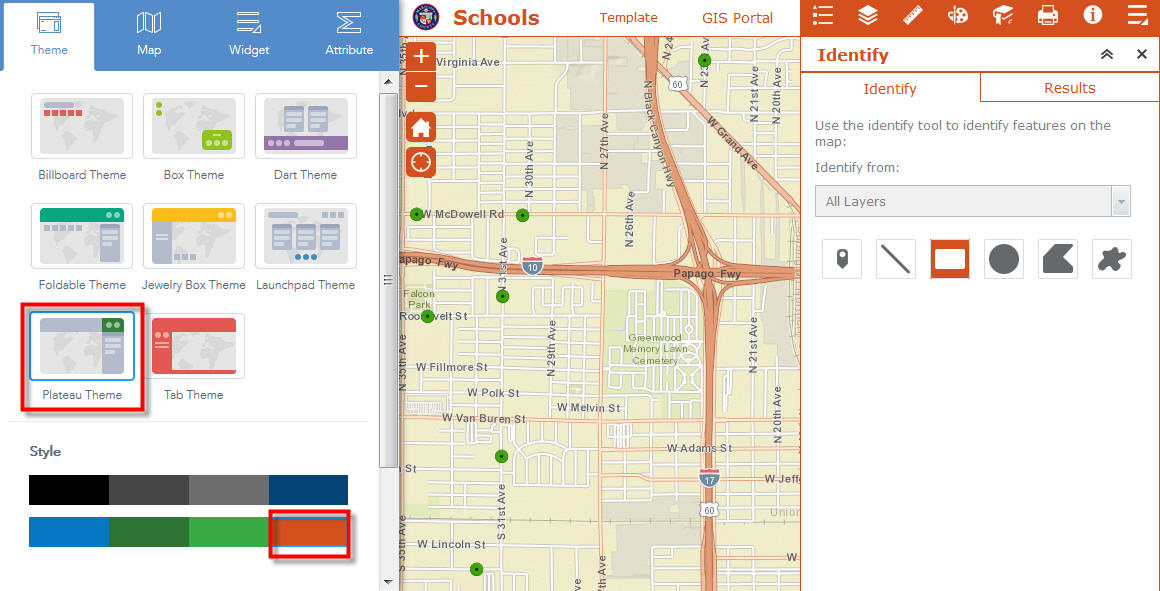

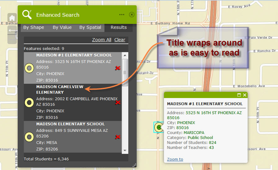

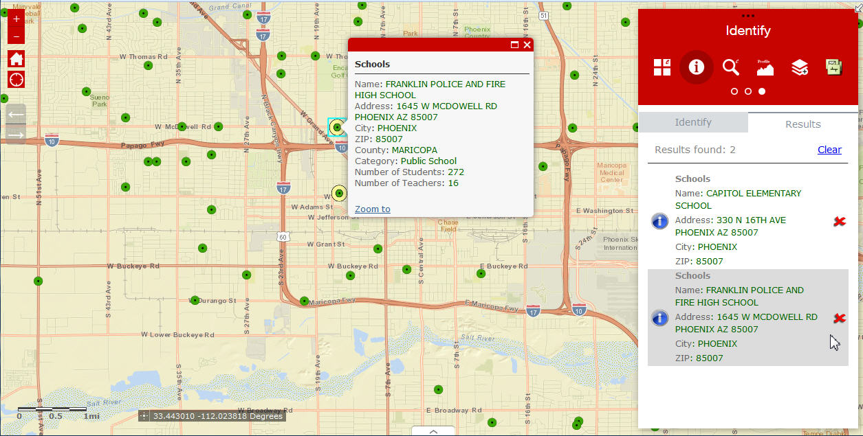

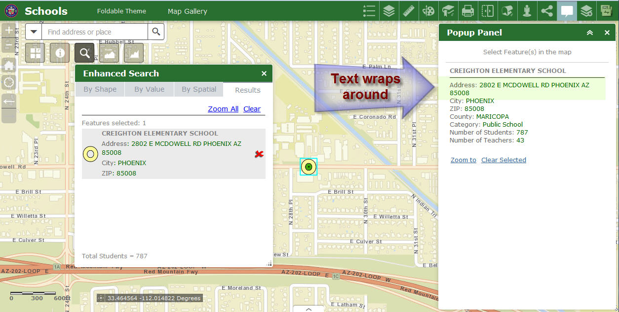

DAVIDDAS1

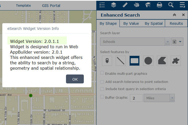

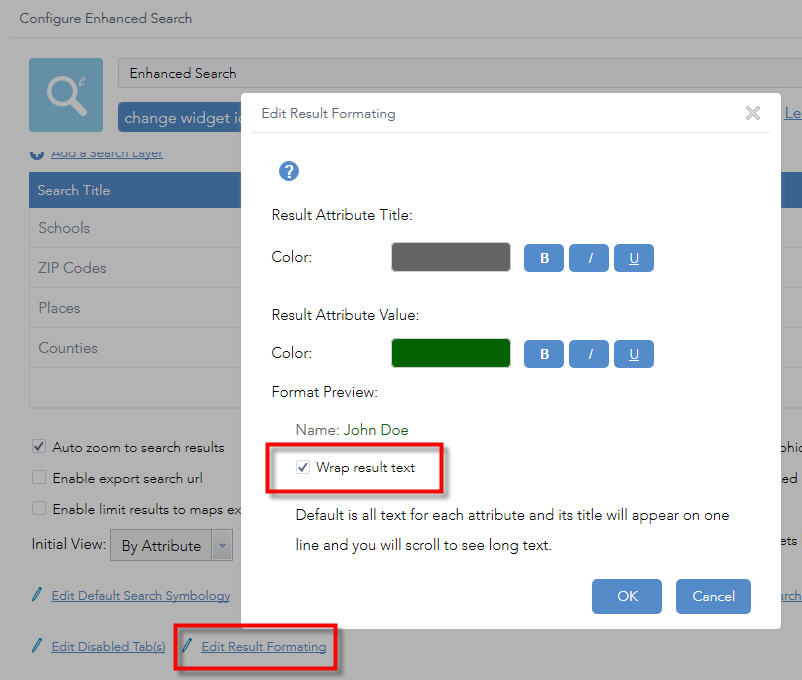

Hi Robert,

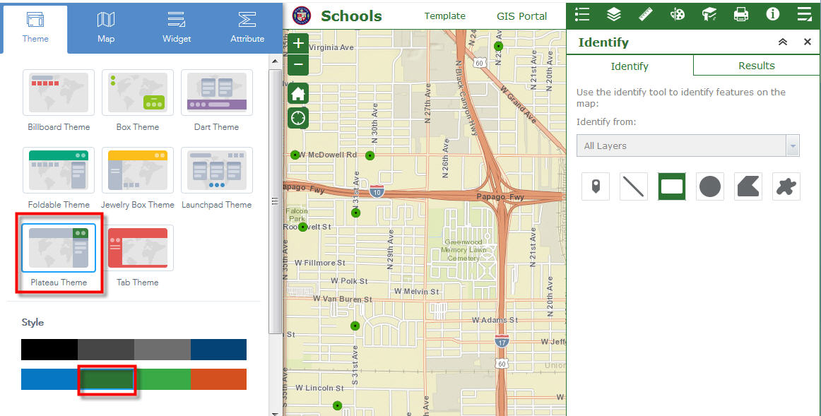

Thanks a million for releasing Identify 2.0.1.1 and Enhanced Search 2.0.1.1
Your CSS fix now includes all the Style Colors in the new Plateau Theme.

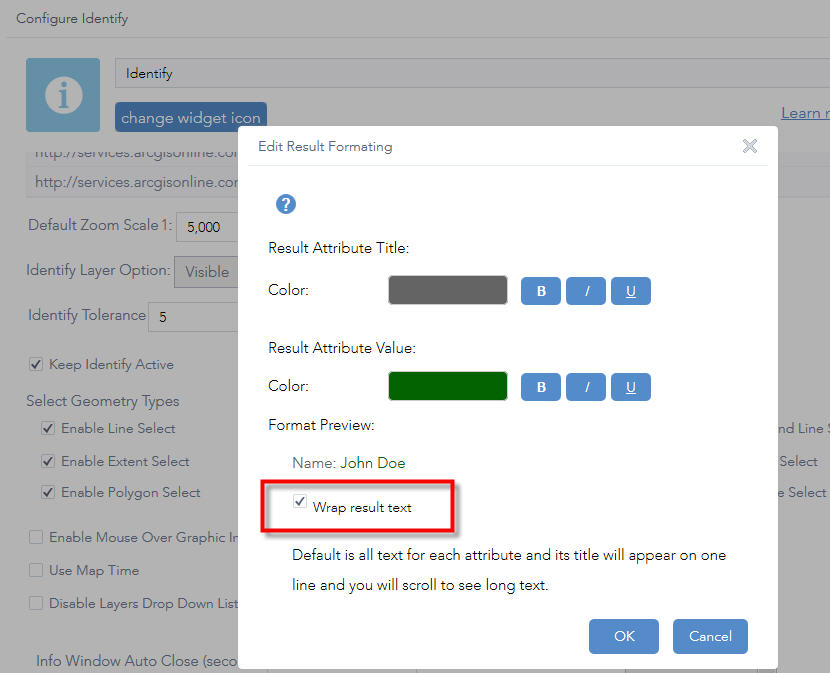

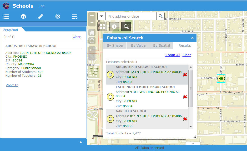

I like the option to Wrap the results text.
Just like your Identify Widget, the Enhanced Search Widget controls now honors the Style Colors.
I checked the option to Wrap the Results Text.
However, the text in the results pane did not wrap around.
I still see the scroll bar at the bottom of the results pane.

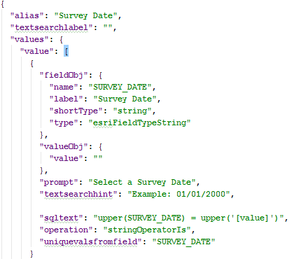

Here is the config_Enhanced Search.json file:

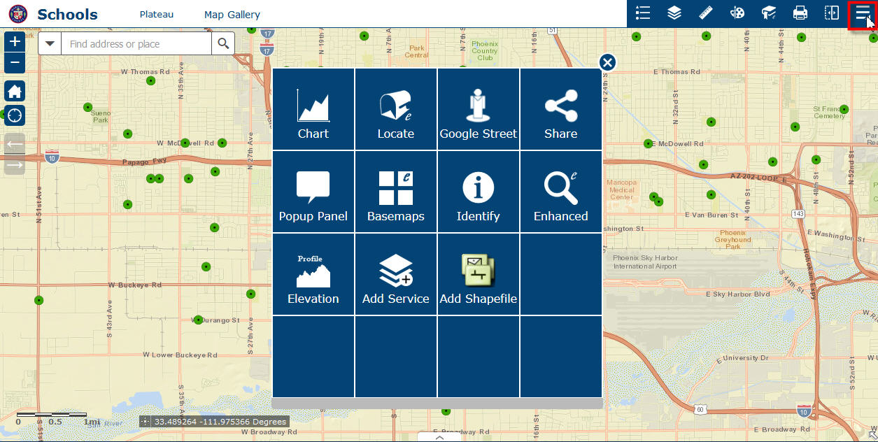

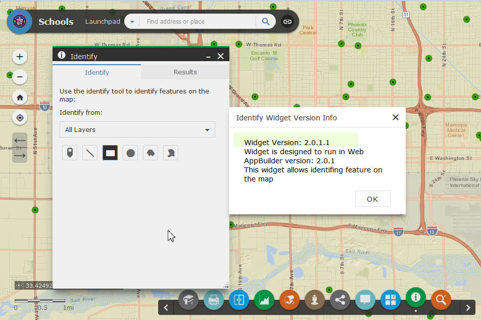

Hi Robert,
Thanks for releasing Enhanced Search Widget 2.0.1.2 today!
I made 8 Web Apps using the latest versions of your Custom Widgets as of 5/11/2016
Enhanced Search Widget 2.0.1.2, Version 53                   5/11/2016
https://community.esri.com/docs/DOC-1731
Enhanced Basemap Gallery Widget 2.0.1, Version 10            4/20/2016
https://community.esri.com/docs/DOC-2888
Google Street View Widget 2.0.1, Version 8                      4/21/2016
https://community.esri.com/docs/DOC-2991
Share Widget 2.0.1, Version 12                                4/20/2016
https://community.esri.com/docs/DOC-3247
Identify Widget 2.0.1.1, Version 23                               4/27/2016
https://community.esri.com/docs/DOC-3250
Elevation Profile Widget 2.0.1, Version 9                      4/26/2016
https://community.esri.com/docs/DOC-3342
Map Progress Indicator Widget 2.0.1, Version 6                     4/26/2016
https://community.esri.com/docs/DOC-6416
Enhanced Bookmark Widget 1.3, Version 4                     12/15/2015
https://community.esri.com/docs/DOC-6889
Enhanced Locate Widget 2.0.1, Version 8                                  4/26/2016
https://community.esri.com/docs/DOC-7046
Popup Panel Widget 2.0.1, Version 7                                 4/20/2016
https://community.esri.com/docs/DOC-7355
Other Custom Widgets:
Add Service Widget 1.2, Version 8                                 11/17/2015
https://community.esri.com/docs/DOC-6263
Add Shapefile Widget, Version 2                                 9/18/2015
https://community.esri.com/docs/DOC-6907
Zoom Previous Next Widget 1.1.1, Version 3                      5/13/2015
https://community.esri.com/docs/DOC-6111

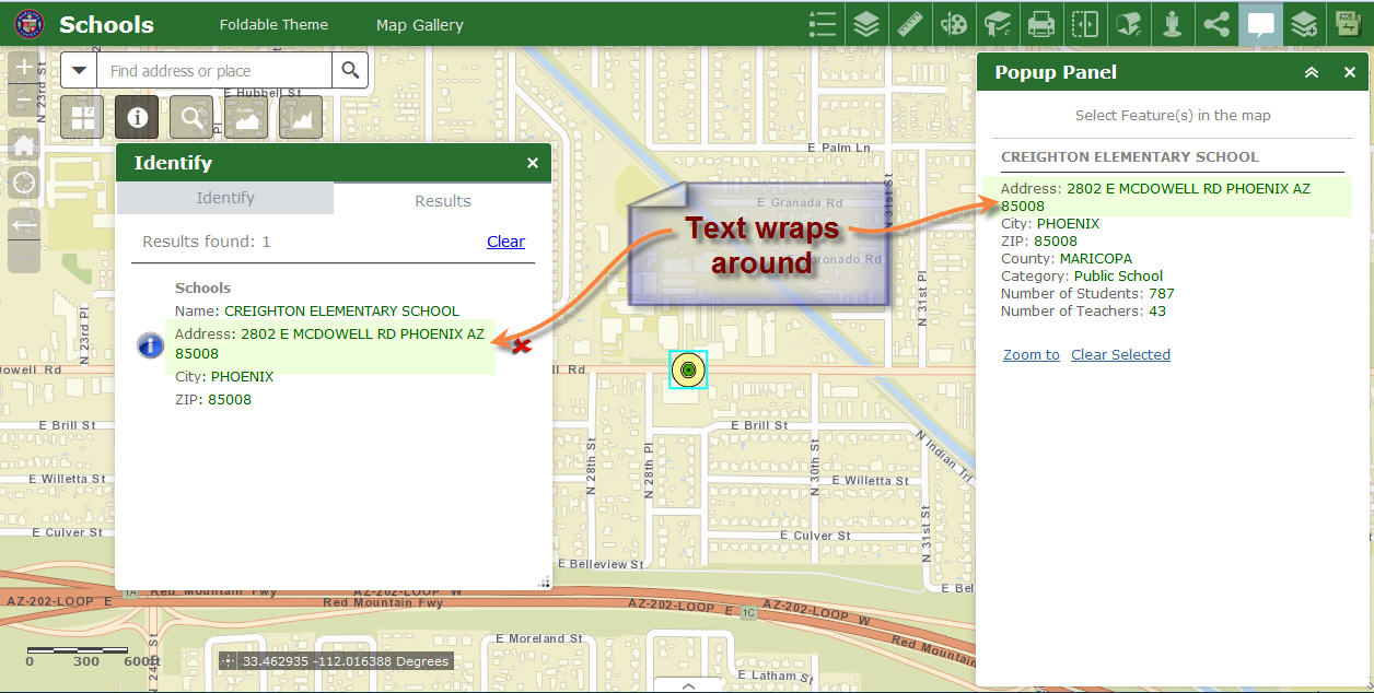

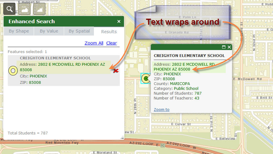

Foldable Theme
http://www.tapasdas.com/Maps/Phones/app177

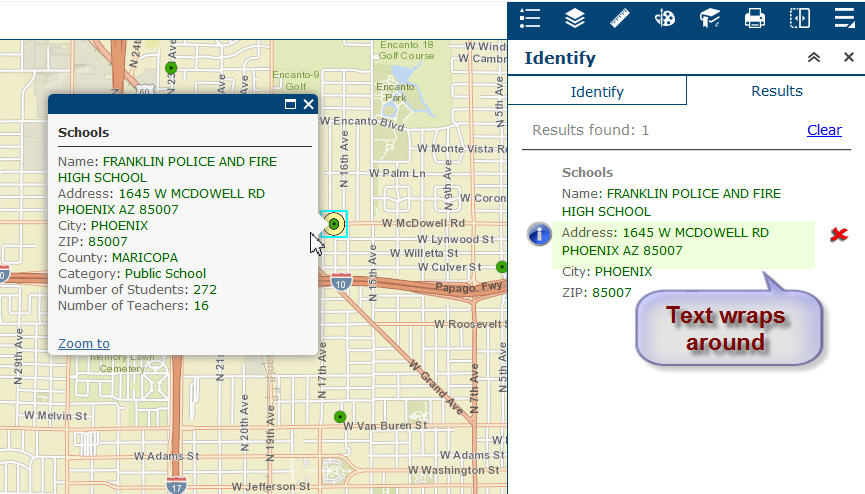

The text in the result pane now wraps around correctly.
You have fixed this issue.

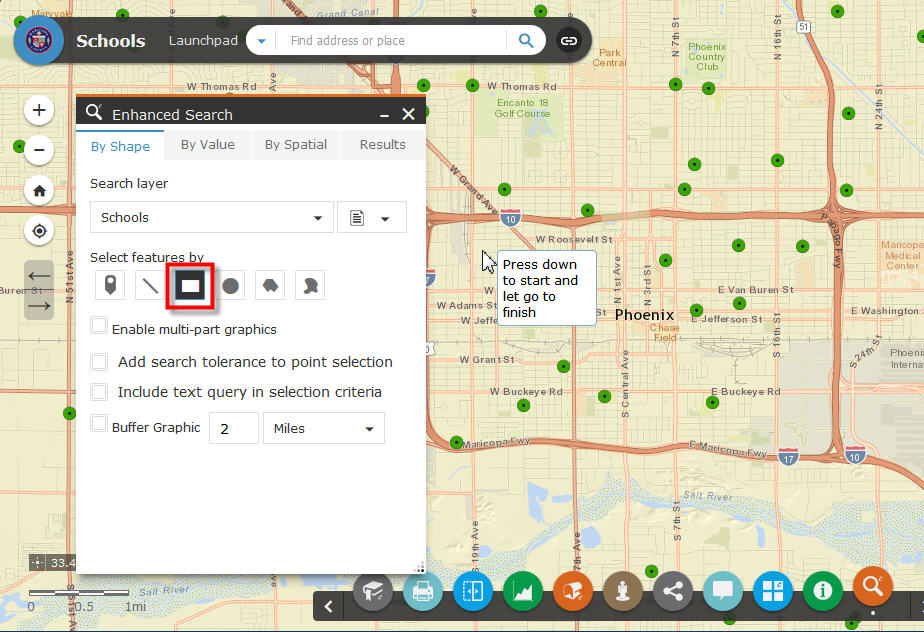

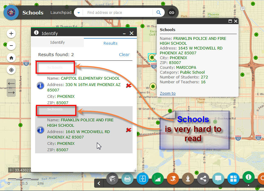

Launchpad Theme
http://www.tapasdas.com/Maps/Phones/app178

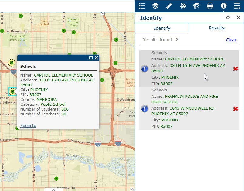

With the Identify Widget, the Layer Name is very hard to read.
This is peculiar to the Launchpad Theme only.

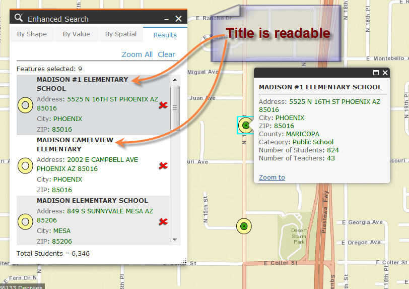

The same issue comes up with the Enhanced Search Widget.
The Title Text is hard to read.

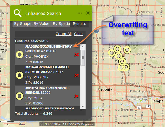

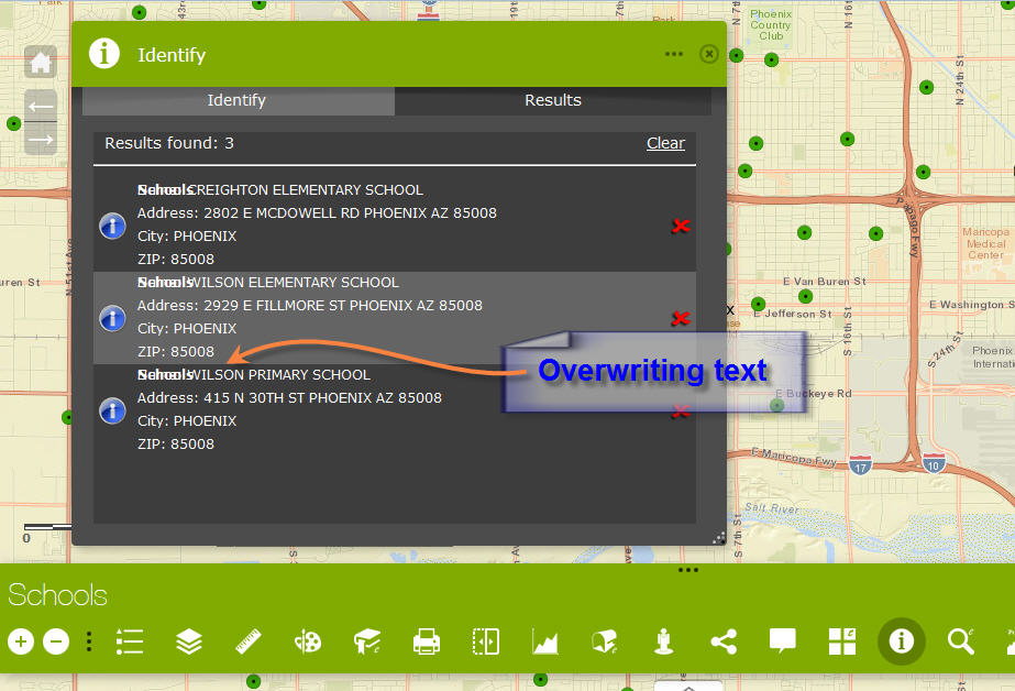

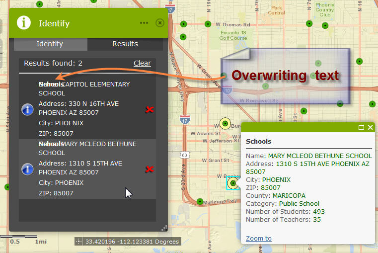

Dart Theme
http://www.tapasdas.com/Maps/Phones/app179

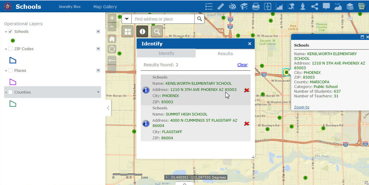

I see some overwriting text with the Identify Widget
Even when I resize the widget, the issue remains
The Enhanced Search Widget also shows the same problem with overwriting text.

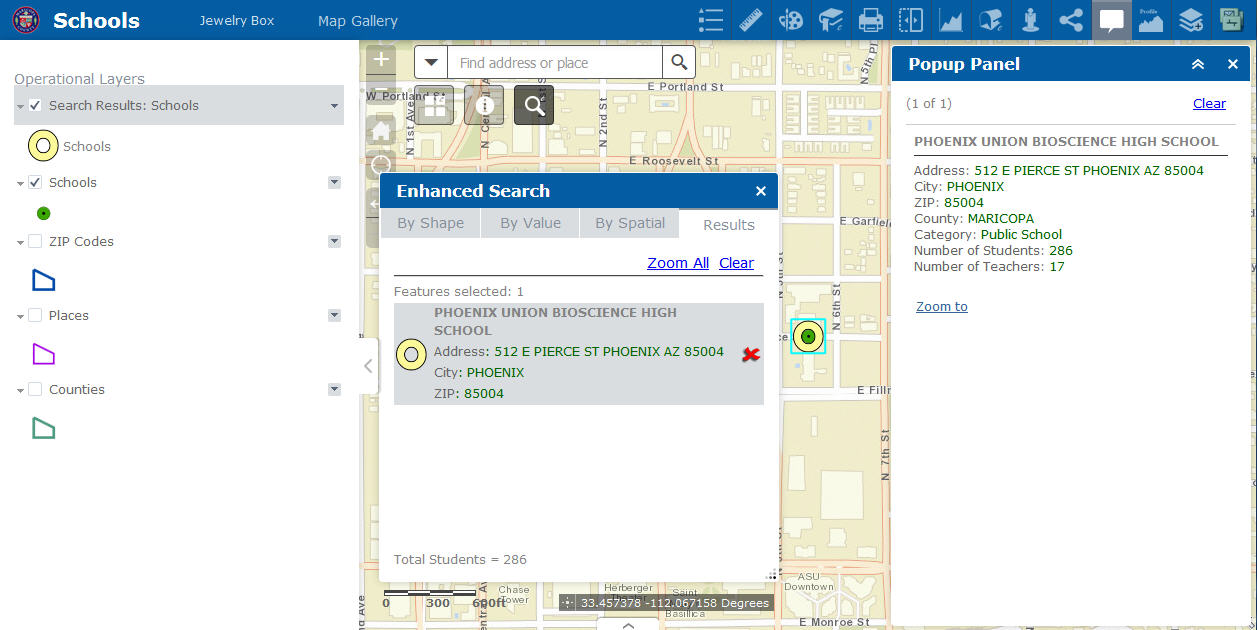

Jewelry Box Theme
http://www.tapasdas.com/Maps/Phones/app182
Identify works perfectly.
Enhanced Search works perfectly.

Plateau Theme
http://www.tapasdas.com/Maps/Phones/app183
Identify works fine.
Enhanced Search works fine.

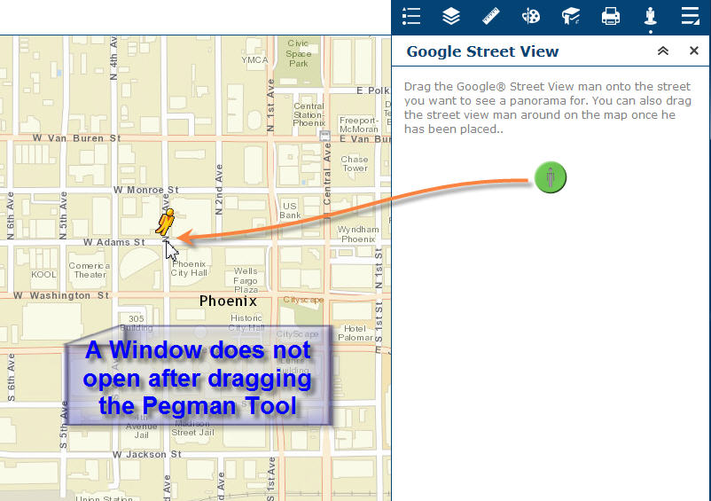

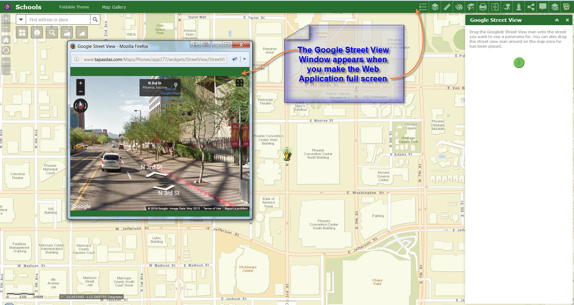

Sometimes I have been experiencing an intermittent problem with the Google Street View Widget.
The window does not open after dragging the Google Pegman Tool.
There is no way to escape out of it. The Google Pegman Tool is permanently latched to my mouse cursor.
I found this workaround.
If you make your Application Window Full Screen, then the Google Street View window appears like so.
All your other Custom Widgets are working perfectly in every Theme.

Tapas,
  Thanks for the feedback. I will work on those CSS issues for the next release. This fix will address the white title in launchpad theme for both Identify and eSearch:
The fix is add this css rule to the Identify widgets style.css file:
.claro .jimu-launchpad-panel .identify-list-item .title {
  color: black;
eSearch:
.claro .jimu-launchpad-panel .search-list-item .title {
  color: black;

DAVIDDAS1
Hi Robert,
Thanks for your super fast fix with  the new version of Enhanced Search Widget 2.0.1.3 today.
I have updated the 8 Themes with Version 54 of your Enhanced Search Widget, and they are working like a champ.
Launchpad Theme
http://www.tapasdas.com/Maps/Phones/app178/
The Title is now easy to read in solid black.
Dart Theme
http://www.tapasdas.com/Maps/Phones/app179/
The Title wraps around and is easy to read.
RichBell
Robert,
Thank you for the quick URL parse fix. I noticed another issue.
1.) In the result InfoWindow popup the Fieldname is also "Wrapping" to the next line along with the record information.
2.) How do you remove a field from displaying in the attribute table but still display that field in the Popup window?
2.) What is the proper configuration to select a unique value from a date field? I get a string of numbers in results, no date.
Thanks
Richard
MVP Emeritus
Richard,
If you do not want this then turn off "Wrap result text"
That is not possible
3.) What is the proper configuration to select a unique value from a date field? I get a string of numbers in results, no date.
That is not an option. It looks like your date field is not an actual date field type, but a string. If you use the widgets settings UI you will see that things that are not allowed in the widget are disabled so there is no need to work with the json directly because if the settings UI does not allow it then the widget does not support it.

Dear Robert,
Can I somehow use the customized popup from my web map to be shown with the search results? I have seen in another discussion that there are problems with using the web map defined popups with search results. I was hoping that eSearch would solve this. But it seems like I can only say no popup to show from the results list or I get the popup as defined by the widget.
Alternatively: Can I change the result popup somehow the way I did in my web map? For example using a tabulator between Attribute name and value to make the attributes easier to read? Or to define to show the data in a table? In which file would I define this?
Added: I don't want the link that I defined for the popup to show in the results list! In which file is that configured, please?
Thanks in advance!
Nicole_Ueberschär
And another question: Where could I possibly tell the widget to clear the selection when closing the eSearch Widget? I found the function clearSelection in List.js but I don't know how I can "attach" it to the closing X.
Nicole_Ueberschär
Sorry for this flood of questions...
I was wondering if (and where) I could add or change the options for the selection: Instead off adding to previous selection I would like to limit the new search to previous search results.
MVP Emeritus
Nicole,
Sure this ability was added in version 2.0.1.2.
If you are using the popup from the webmap then you just do not include that field in the eSearch results when you configure which fields to display.
If you un-check "Add Result as Operational Layer" then the search results will be hidden when you close the widget. If you have "Add Result as Operational Layer" then it is assumed that you want the results to stay unless explicitly cleared.
There is no option for "select from current selection".
Nicole_Ueberschär
hmmmm,
- Regarding my web map popups: Only when I "Disable search results popup" I get the web map popup when clicking in my feature. But then I loose the nice functionality to get the popup straight from the results list. Is there a way to combine both?
- Link: I tried to make the popup to look about the same as from the web map because of the above mentioned functionality. In my web map popup I have a customized text that shows most of the attributes and on top a link for sending an email. When I add a link in eSearch I cannot specify that it should only show in the popup. Do I?
- Selection: I realized that there is no option "select from current selection" but I thought it can't be too difficult to add. Isn't that mainly a matter of SQL definition? Could you maybe point me to the coding lines where the available options are defined? Then I could see how it looks like.
Thanks Robert!
MVP Emeritus
Nichole,
I find it strange that you are not seeing the webmaps defined popup. Can you check that you are actually using the latest version of the eSearch in your app? To do this hold the Alt key and click anywhere in the widget body and a message will display showing the widgets version number.
You can check the popup only column in the fields list.
Not trying to be sarcastic, but if it were that easy I would have already added it. You can look at the buildWhereClause function but there is a lot more going on with adding or removing of Features from the currentFeatures array.

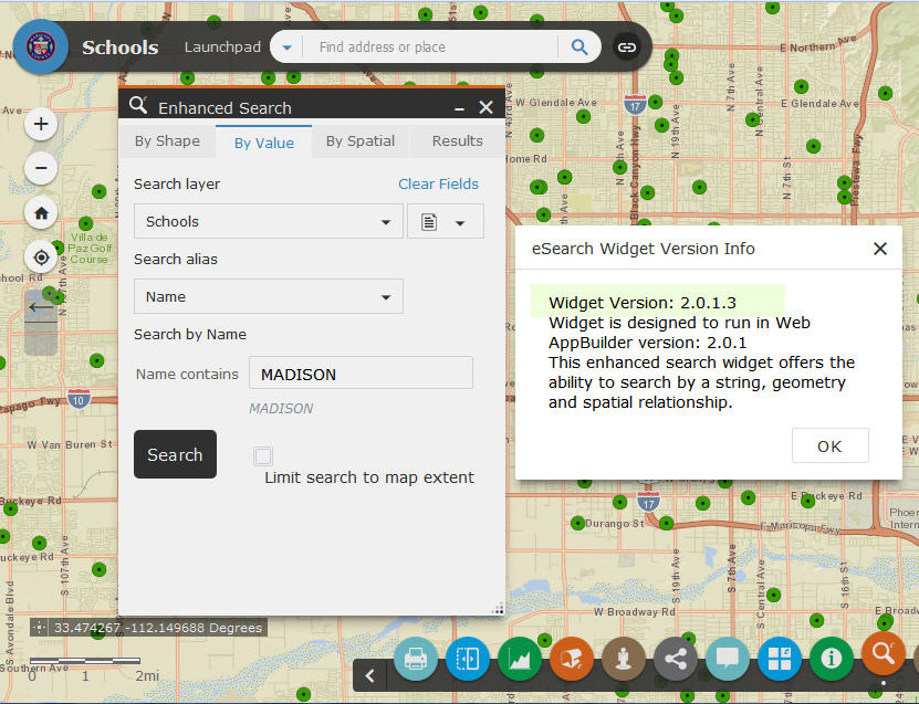

NicholasMcNamara
Easy question here. If I have an existing app and I want to upgrade from 1.3 to 2.0, is there a simple way of doing this without breaking anything? I'm a little hesitant to just copy over the files in the app and the builder because I don't know if that's going to cause me an issue later on. And there seems to be no handy upgrade widget button like in the flex view
I also see that I imported an app from an old version of WABde (I had to wipe out everything and start over). Importing an app with a widget in it seemed to import that widget into the program generally as well. That's interesting.
RupaliKiran
Deactivated User
The version I am using is:
"name": "eSearch",
"label": "Enhanced Search",
"platform": "HTML",
"version": "2.0.1.3",
"wabVersion": "2.0.1",
"author": "Robert Scheitlin & Esri R&D Center Beijing",
"description": "This enhanced search widget offers the ability to search by a string, geometry and spatial relationship.",
"copyright": "2016",
"license": "http://www.apache.org/licenses/LICENSE-2.0",
"properties": {
"hasVersionManager": true
-Rupali
